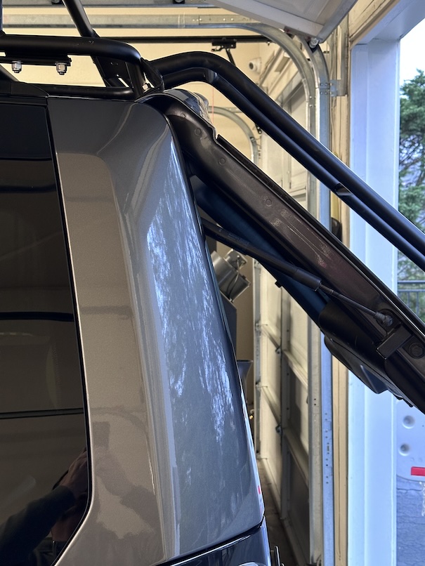

You gotta post pics. All I can say is my Gobi was dead on with zero fitment issues or adjustments needed. Followed the instructions precisely and haven't looked back since. I know that's not helpful, but there's gotta be something more going on here.
And how do you mean the ladder hits the tailgate?

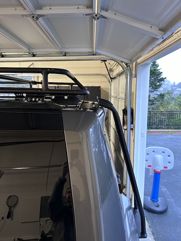

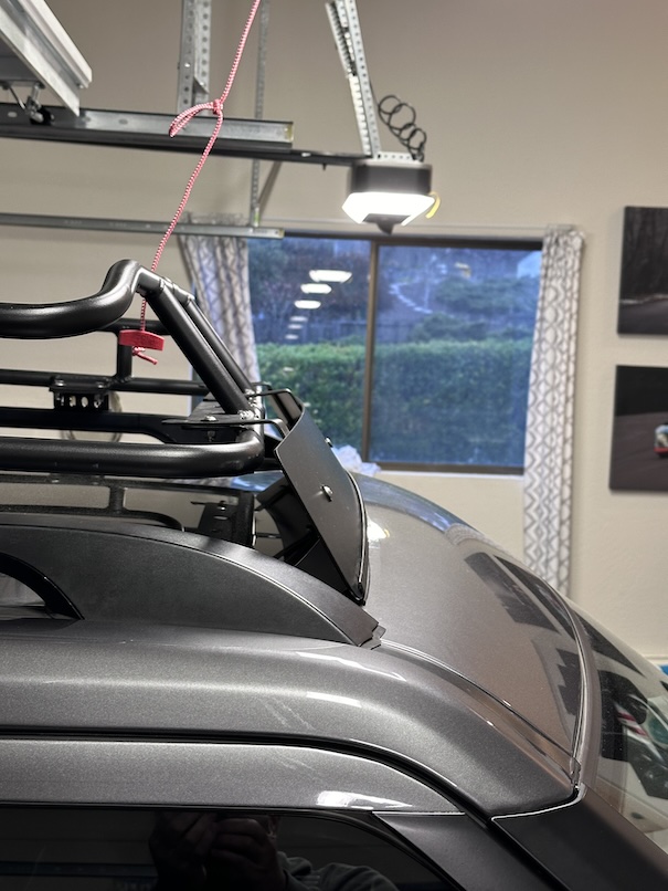

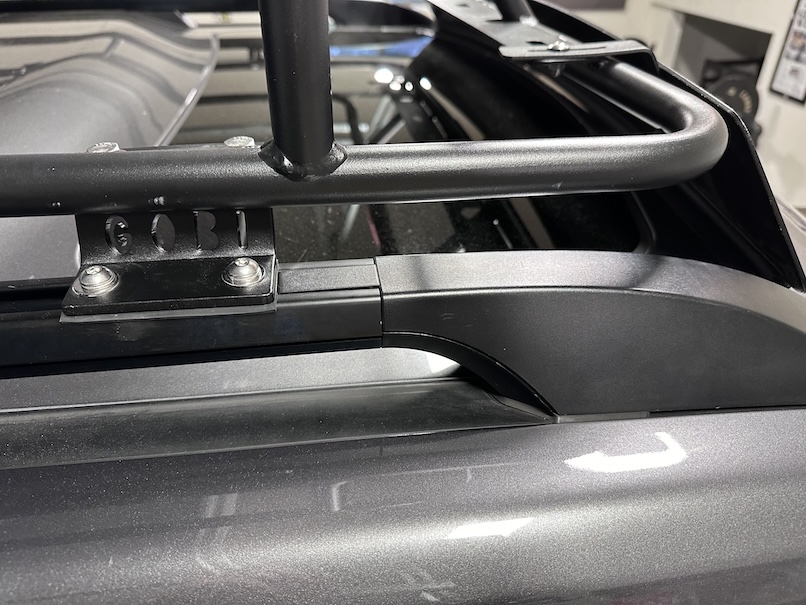

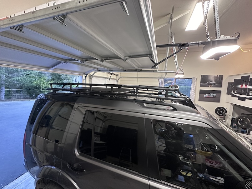

I am attaching photos to this post. You can see where the front bracket of the rack is all the way forward on the rail. I thought maybe to pull off the sloped cover, cutting off the little 2" tab... that would allow me to slide everything up a bit more. (but, there is a screw in the rail there so it may not work without removing/shavig that screw head. Also, I don't know if that would actually buy me enough space.
The overall unit, from furthest back of the rear lateral bar, to the absolute front of the front lateral bar, os 7', 4.75".
The rep told me a while back that all of the racks are the same for all of the rail combinations, but I wonder if the mounting brackets on the rack are in different positions for the different roof combinations.

Do you mean the stainless steel Gobi bolt? If so, then no. If you mean the Landrover Torx screw that is at the bottom of the rail (not visible in pics or at the moment).. then, maybe. In pic 3... which shows the plastic "slopy" cover that transitions from the rail to the rooftop... there is about a 1.5" plastic tab/tongue. I am thinking that if I cut right at the seam, then I can slide the whole rack up about 1.5" which might be enough to clear the ladder/tailgate.
But, before I cut anything (permanent) I'd like to hear from Gobi or another owner that doing so solved/will solve the issue....
