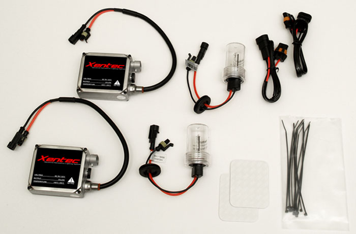

quick question, i guess to nwoods mostly... just got a xantec kit, does look easy but I have one quick question before I install this evening...
The clear dust covers... the plastic encasement that screws shut around the bulb... its this necessary to leave around the bulb or is it just for shipping safety? once the hid bulb is securely seated inside the mount no extra dust case would be needed?
The photo shows the clear dust case around the bulb Im refering to.. and by leaving it in place it doesnt look like its gonna fit without some serious mods to the stock halogen mount... but without looks like it will fit perfect...
(additional link to the photo: http://64.40.159.224/ebay/Xentec/XentecKit.jpg )
Curious if you left these clear dust covers on or figured out a way to include them.
10 MINS LATER UPDATE:
OK SO I THINK I REALIZED THAT THOSE CLEAR THINGS ARE JUST FOR SHIPPING THE BULBS IN AND PROTECTING DURING THE INSTALL... BUT ILL STILL LEAVE THIS POST UP IN CASE IM WRONG OR UNTIL I INSTALL.
Nope, take off the shipping tubes and insert just the bulbs.
If you are doing it tonight, take a before and after photo with the lights on so we can see the difference.
That kit looks a lot like the one I installed. Be mindful of the little metal clip that is in the lamp housing. It's under a lot of tension. Put a rag over the hole to catch it when you remove the clip. BEFORE you remove, get a good understanding of how to reinsert it. Its easy if you do it right, it's VERY difficult if you don't.
Also, if your new lights start out very bright, then quickly dim down, then gradually (over 1 or 2 seconds) warm up to full strength again, that seems to be normal.
