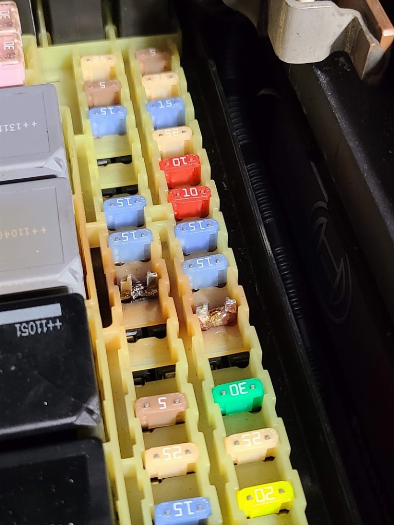

I’m glad I’m not the only one with a browned fuse box plastic though it’s still concerning. Ive pulled the fuses and just click it off every time it’s cold when I get in. Would love to not have electric gremlins though so if anyone has suggestions on checking the wiring I’m all ears

So i replaced my fuses 2 months ago with 40a because they were blown. Have used the windshield numerous times since, and today it stopped working. This is what I saw when I looked at the fuses.
Any suggestions? Wiring in the pillars looks good. Fuyao windshield.

Mine looks the same. I have had the Fuyao, Benson and Pilklington blow the passenger side (driver works). Upsizing the fuses is a dangerous game and I think upsizing to 40 is no a good idea. It seems the windshields draw too much current.

I feel this comes down to cheaply made aftermarket glass that has too high of resistance in the heating elements. all wiring and connections are good. I replaced fuses last night and it worked perfect this morning. Im sure its only a matter of time of failure, as the fuses slowly melt.

Maybe but I had a Pilkington which gave me the same problem. The problem isn't too much resistance in the glass it is too little. Melting fuses? I wouldn't put 40s back in there unless you like the remote possibility of an an engine fire.
