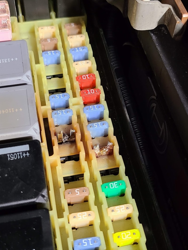

So i replaced my fuses 2 months ago with 40a because they were blown. Have used the windshield numerous times since, and today it stopped working. This is what I saw when I looked at the fuses.
Any suggestions? Wiring in the pillars looks good. Fuyao windshield.

Have you checked the underside of the fusebox for a diagram? My LR4 has them swapped to the F-slots above to the left (where the pink 30 A fuses are)
1,412
The windshield fuses have moved around based on model year. For sure the 2006 LR3 and 2010 LR$ are where the picture shows (not the f slots). Later years may be in other places and is further proof this had been a concern for Land Rover. Perhaps the non F slots should never have had 40A placed in there. That would make sense and why Land Rover abandoned the TSB.
