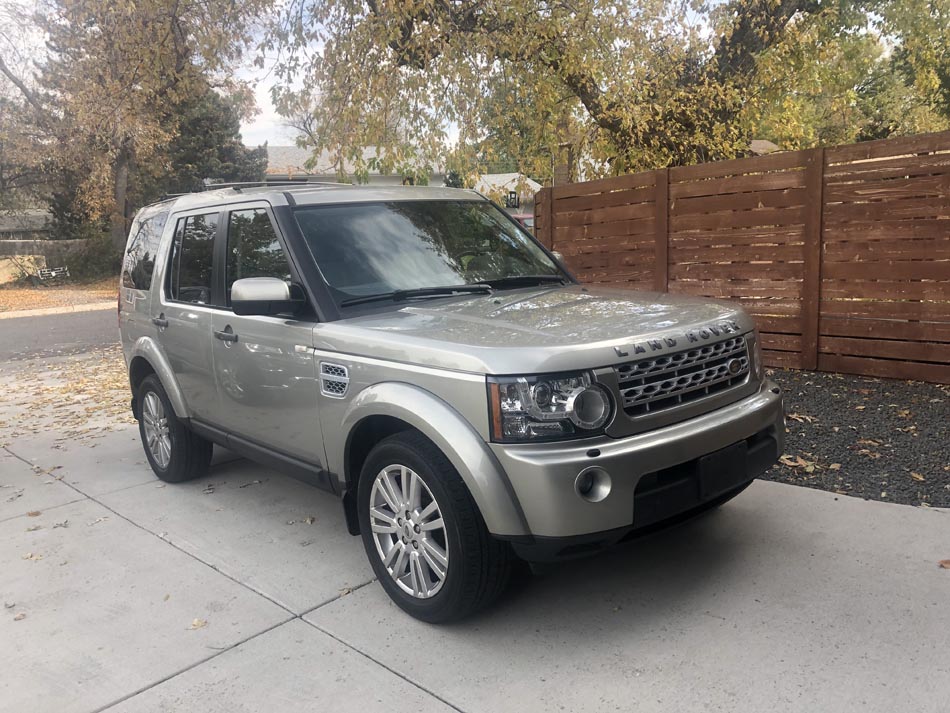

Could a 2010 LR4 be running strong at 155K with none of these issues (timing chain, coolant crossovers, air suspension)? Would that be a unicorn?
EDIT: added manufacture year year 2010.
3,097
1,881
Timing chain, yes. Especially if it's a 2013 or newer.
Coolant pipes, water pump, and no suspension parts replaced? Unlikely.
1,420
Your 2010 HSE (non Lux correct?) appears to be well cared for. At the age it is this is the most important factor, the ownership. Not easy to hide a mistreated vehicle when it is 11 years old. What I like is the PO (s) added mud flaps front and rear. You don't see that on a lot of LR4s and it keeps the gravel down.
