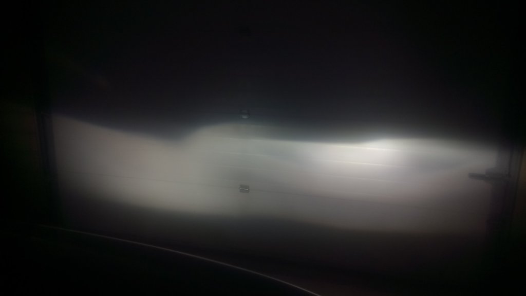

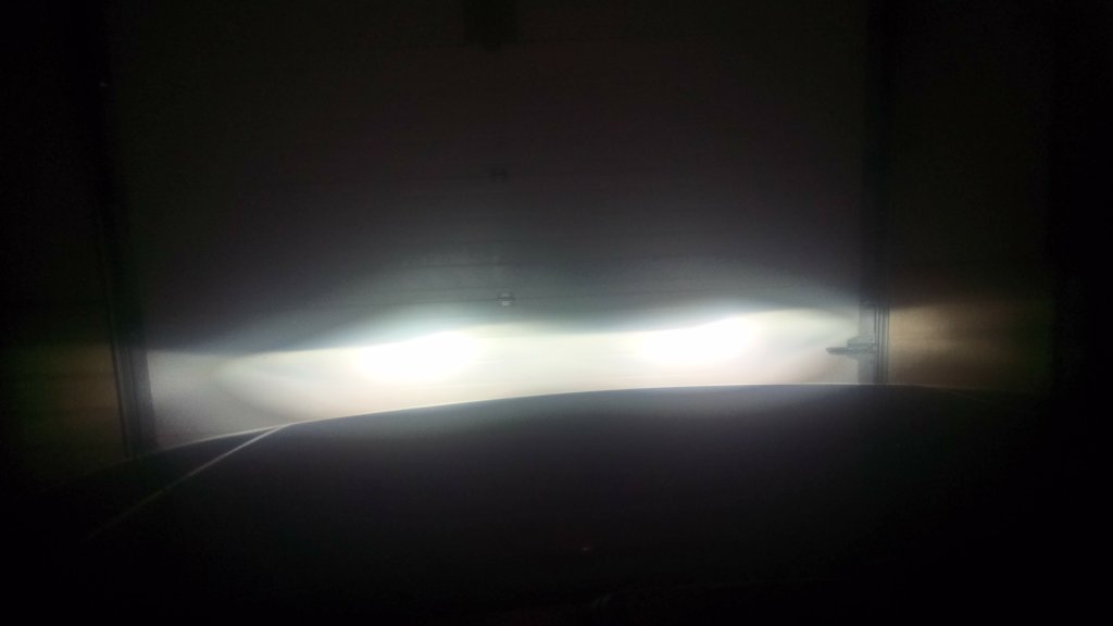

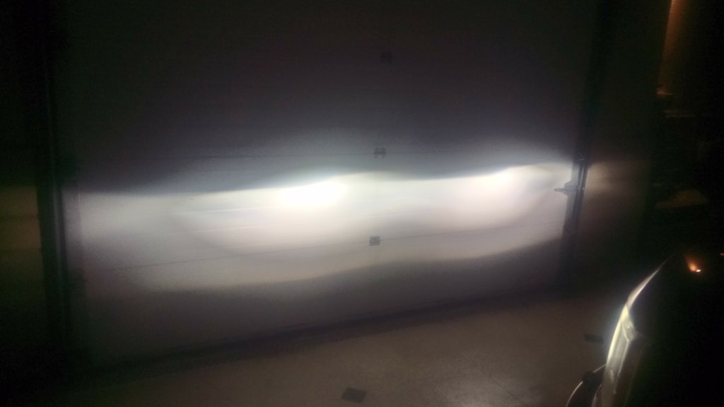

my 2010 LR4 driver side HID headlight cutoff is incorrectly aligned (corrupted) with OEM D3S, ... any solution any one, please

Pretty sure the driver's side is supposed to be dipped at the top of the beam, which prevents blinding oncoming traffic.

hello everyone … my headlight cutoff issue is solved
the problem was the bulb was not aimed (installed) properly
