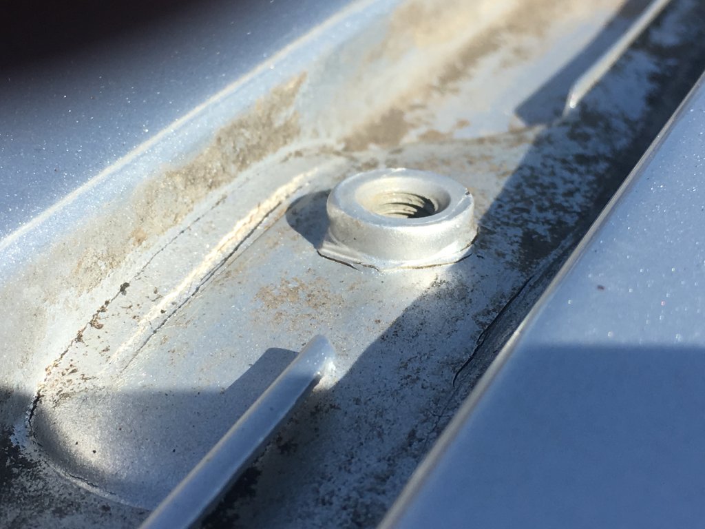

I’ve got a troubled bolt broken off inside one of these roof rail nuts (what are these called anyway?) and it’s not budging, even after quite a bit of work with various bolt extractors. I’m wondering if it would be easier to replace this nut, take it to a shop and have them cut it off and weld a new one on, or possibly drill this out and rethread it.
Anyone know how these things are secured to the roof? I can only see a bunch of softish substance surrounding it, which I believe is to prevent leakage to the interior.
Any tips are appreciated,
Ron

Try penetrating oil first. Put a few drops in every day for a week or two. Patience is necessary for penetrating oil!
I use Kroil penetrating oil. It’s the best stuff I’ve ever found.
If you can get purchase with an extractor it’s only the rust and crud holding it in and the Kroil will deal with it.

I broke off a bolt in one of these.. CAREFULLY drill it out with an opposite direction drill bit, mine came out about halfway down. PB blaster the hell out of it, let it sit, and get drilling..
You can have someone cut it out and replace it, but I think that's a last option.. These channels get a lot of rain, and if you start getting rust up there things are going to go downhill fast..
Good Luck!!

Yes drill it out. I've changed out my rails several times and always add a little lithium grease when re-installing the bolts.
That's a great idea. I wish I would have done that when installing my rack!
