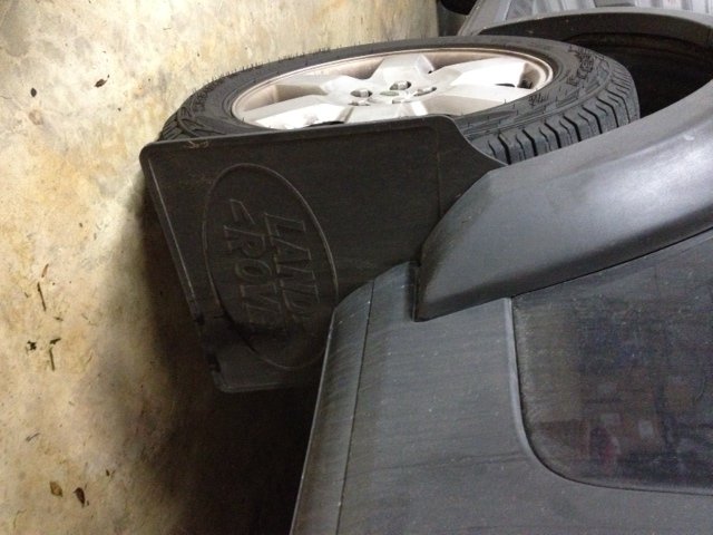

After seeing a 20ft spray coming off the back of my tires I decided to put on some mudflaps. The OEM flaps are less than ideal, I wanted to get some nice and big rubber ones. Here is what I did.

Rear:
I started with doing the series III ones as some have done over on disco3.co.uk: http://www.disco3.co.uk/wiki/index.php/Mud_flaps
You need to trim the inner side to fit around the exhaust. But once you cut the top corner off, the mud flap starts to loose it's shape and cup. To fix this I got a piece of scrap aluminum and attached it with plastic rivits that I got from McMaster-carr to the bottom of the flap. This added some needed rigidity.
To mount the mud flaps I drilled a series of holes through the plastic lines and one through the wheel flare molding. You can reuse 1 attachement point. I started out by using the mounting hardware that came with the mudflaps, but I think I am going to change these out with the plastic rivets I used on the fronts.
Mack73
Sep 9, 2009
188
Front:
I haven't seen anyone do a really good job on the fronts. I decided to give the Range Rover Classic's a try and see if I can make them work. Just like the rears, a cut is needed on the inside to go around the body mount. Again since the cut is made, the stiffness is lost. To fix this a brace was made out of the excess aluminum and riveted to the bottom of the side skirts.
Mounting, 2 existing mounts can be used. Unlike the rears, you can't easily get to the backside of the fender liner. Enter the plastic rivets. Simply drill a hole through the liner and push the rivet in. With the correct sized hole, they hold very very well. Be careful when drilling on the passenger side as the rear heater lines run through this area (if you have the rear heater) and you won't want to nick one of these lines.
Overall all I am super happy and they work very well.
