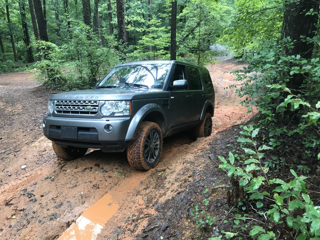

2011 LR 4 HD 168,000 and not a single issue. Just put Goodyear wrangler duratracts on and now it’s unstoppable off road
