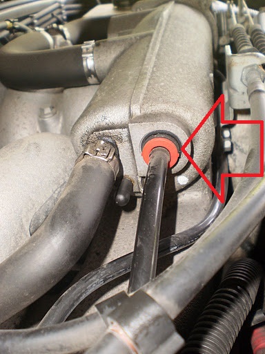

I got it but I broke my emissions line idk if that's what it is the smaller line with the red cap they told me to put jb weld does that sound right
Mx468
May 26, 2012
168
Do you mean this line? Here's a pic. You just push the red cap and pull to remove.
