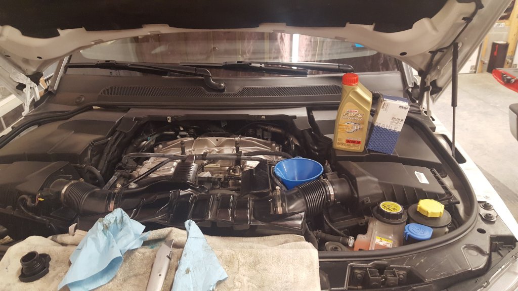

Correct oil usage for the LR4 2016 model? Thanks for being patient. Still a lot to learn.
SAE 0W-20 STJLR.51.5122 is the correct grade and spec for your engine. There are only a few oils that meet this spec....
Castrol Professional Edge E 0w20
Fuchs Titan GT1 EVO 0w20
There is one other but can't remember.
My 16' is under warranty and I use the correct oil and document it just in case.
Am I going to switch to Mobil 1 0w20 after warranty? You bet, but not till then.
