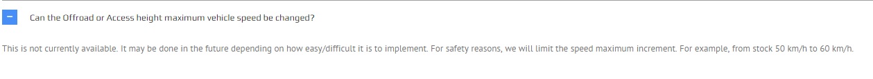

I was doing some research since I couldn't sleep and I found this on the gap-diagnostic FAQ (see pic).
Basically it says the maximum adjusted speed for Off-Road or Access height is limited to 60kph. Is this still true or is the FAQ out of date?
Could you simply adjust the normal access height to the off-road height in order to drive faster at the Off-Road height?
