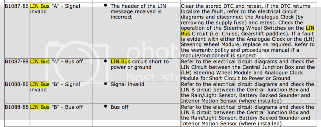

Did you check for any DTC codes being thrown?
Lin bus errors?
The default state for any of those physical buttons should be 'off'.. so if most of all those buttons are acting flakey I doubt it is the switch, more likely the module itself has some type of issue.

Just sounds like a bad switch that keeps firing when you don't want it. Either the module for the steering wheel controls is bad or one of the switches that feed into it. I'd unplug the switches and start with that.
