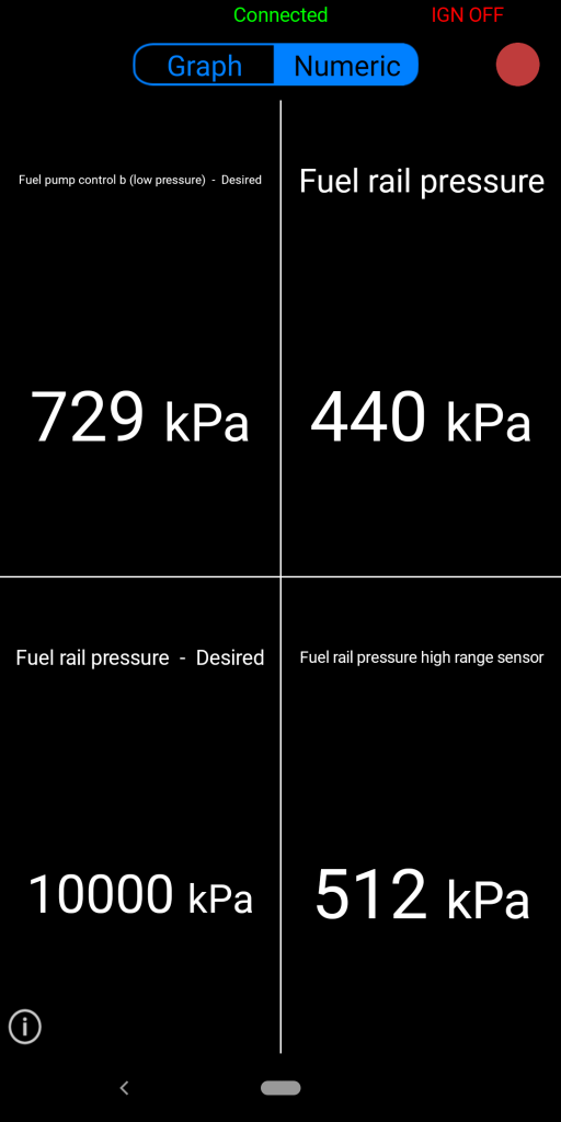

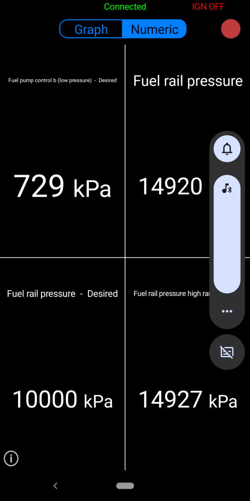

ftillier
Jul 27, 2021
944
514
Portland, OR, USA
Slightly below freezing this morning, after sitting over 12hrs, ignition on values:
And shortly after turning the engine on:

Looks like what I’m observing is pretty normal then. Is there a live value for the low pressure fuel pump that I can see? Is it possible it’s not priming enough? would that make sense even if it was driving perfect apart from cold starts?
