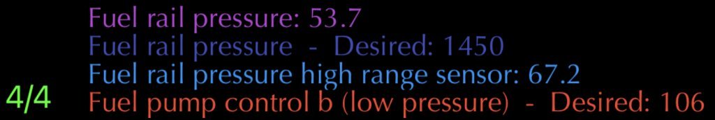

Ok so came back to the car after letting it sit and the first thing I did was check the live values before starting the car. With the battery on I was able to see that my current fuel rail pressure after letting the car sit was 53.7 psi while the desired fuel pressure was 1450 psi. When I started the car it had a couple of extra cranks, fuel pressure was around 400-600 psi then went right up to 2090 on warmup idle at 1.5k RPM. Should my psi be 1450 before starting the car? Would this means I have an issue with the HPFP? Here’s a screen shot of the live values before cranking.

HPFP is mechanical, so if the engine is off, there's nothing that will bring things up to pressure like that until you start cranking. Is the low pressure pump reaching its target?

I was thinking the fuel rail is supposed to maintain some pressure when the car is switched off, and it might be leaking down in this case. So, when you crank after leaving it set, the pumps need to fill the rail again before you get fuel to the cylinders. It’s not going to be nearly the same kind of pressure as with the HPFP cranking, but I think the rail should stay full and should have some pressure in it.
Looks like you were able to get a live reading on the fuel rail with the engine off. Maybe check it right after shutdown, and then at a few time points afterwards. See if it changes. I’ll try to remember to do the same on my car and give you some values for comparison. I’ve never tried the fuel rail pressure live value with the engine off.
When I turn off the car the fuel pressure tends to build up a bit but by the time I get into it aftwr it’s been sitting for a while the car only has 50ish psi of pressure
