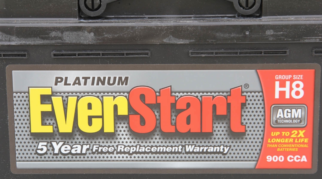

If you do have to buy a new battery, I second the recommendation for an H8 (Group 49) AGM with the best warranty you can find. Some brands are only 3yr replacement, some are as much as 5 years.
Interestingly, the nEverStart brand at Wal-Mart appears to be a quality German-made battery with 5yr full replacement warranty, at a price well below any other vendor (~$150). Edit - photos on their website now show 4-yr warranty, hmm, I'll have to check what they have on the shelf, when it's safe to venture back out into the public. If no store in your area has them in stock, the website will show "not available". And, price seems to vary by region, I'm seeing $150 in CA but $170 now in ID? ?!!!!
https://www.walmart.com/ip/EverStart-Platinum-AGM-Battery-Group-h8/40647529

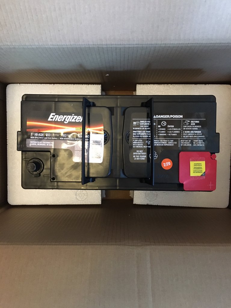

My Energizer battery arrived through Costco today. Very impressed with the packaging and a 2/20 sticker. A few days straight to my door. $250 CAN ($170 US) is a good price for a AGM with 5 year replacement warranty and 50% for a few years after that. No idea who is making the Energizers.
Word on the street is that it is rabbits....
