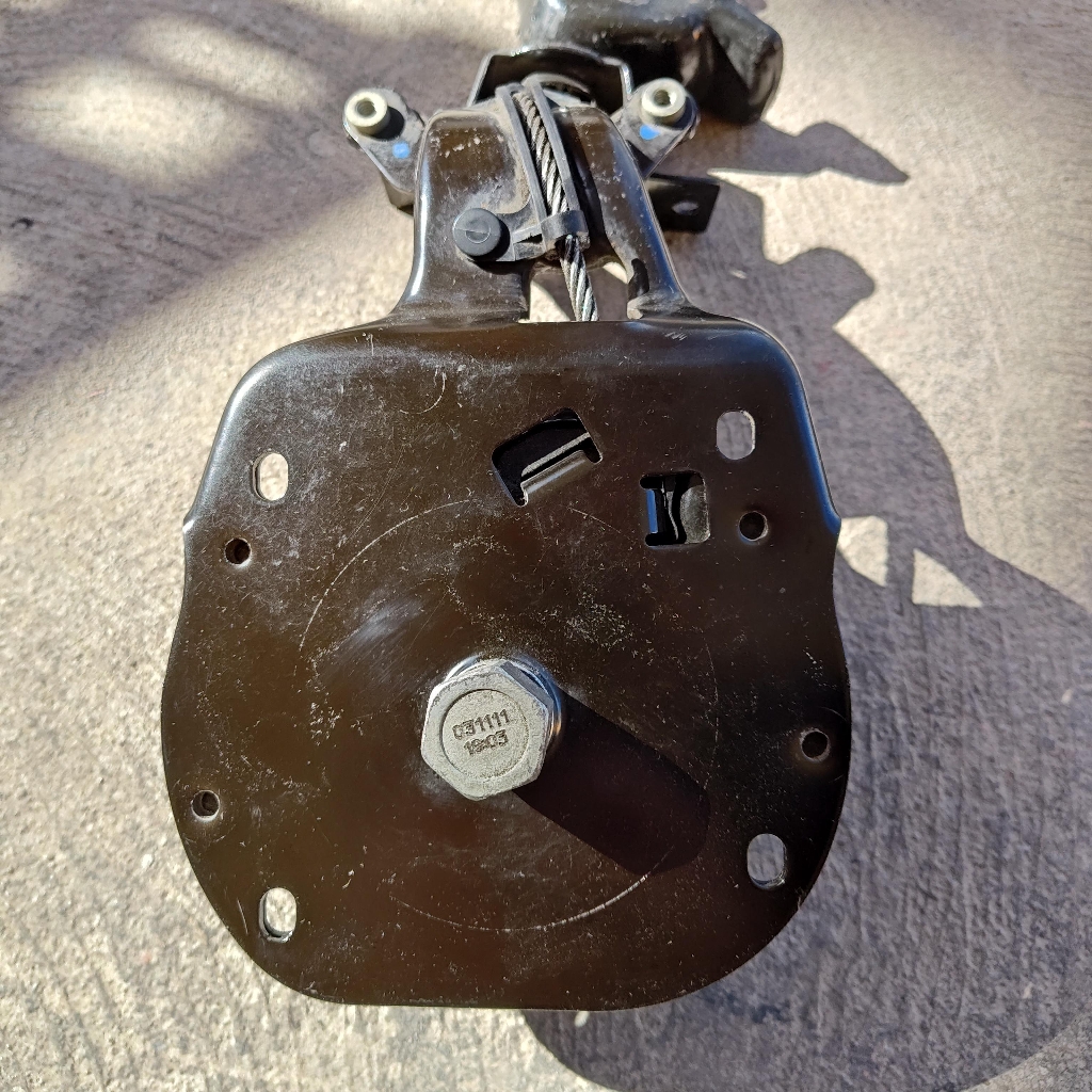

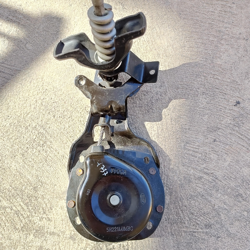

The winch came in and no way is it a rebuilt part. Total lie. Its a used part and could have the same problem as what I just went through. Tbh, the one that came off looks a lot better.

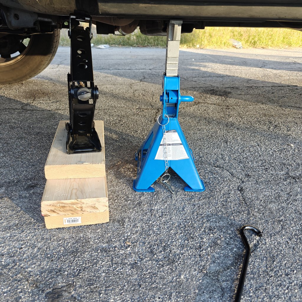

Instead of using the concrete block like in the OP under the jack, I cut up a 2X6 to put underneath instead. Its way better this way, the block I had found near my apartment so I had used it instead of buying a block for it. I was thinking a 6X6 would be better, but I couldn't find any pieces without buying a 20'er.
The jack stand is pretty sweet too. Its a 6-ton and if you rotate the handle, the shaft raises up automatically making it a one handed operation to support the frame with the stand. I found it at Action Autoparts. Another 2X6 or better to stick underneath when in the dirt might be a good idea. If the jack looks tweaked its because it is. I was careless one day and bent it from leaving the ebrake off.

Those lightweight jacks provided with the vehicle are fine in an emergency…. but I never use them at home. I just can’t trust them…. which is why I’m glad you added the jack stand!
I don't trust any jack enough to go under the car without a jack stand. The factory jack is fine for changing a tire, and the tool kit comes with wheel chocks to use on the opposite corner to prevent rolling back.

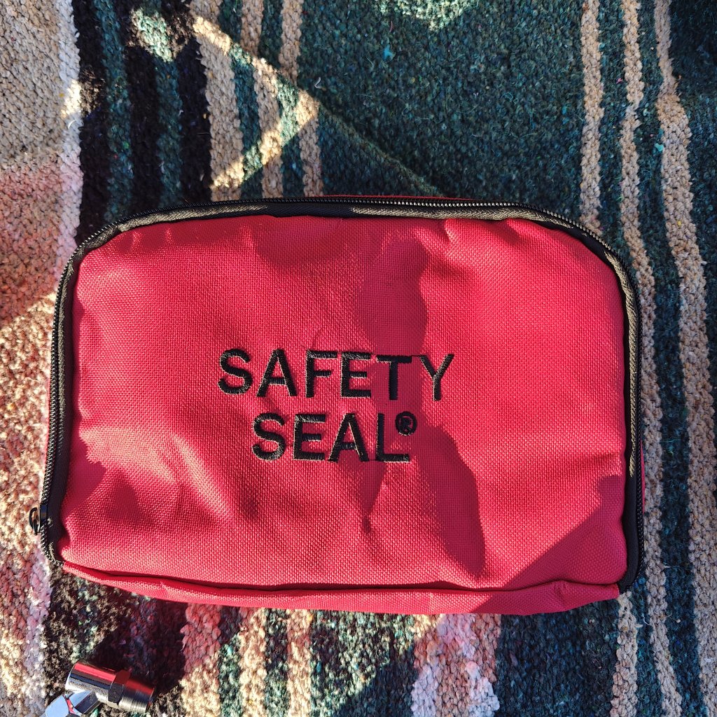

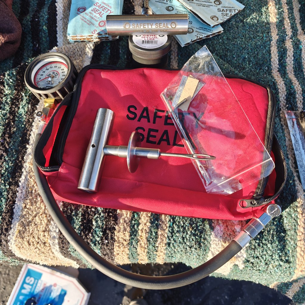

This Land Rover is the first car I've had with a spare tire since 2005 when I had a Silverado truck with the 496CI big block V8 and the Allison 5speed. I'm pretty happy with it tbh. Its a second option where the first would be to plug the tire. I bought a new kit to replace the cheap pos I tried in the original post. The reamer and stabber thing is beefy, it probably weighs a good pound and the handle fits nicely in my hand. Its high quality made in the USA. The kit comes with small strips and regular size strips.
I also needed a pressure gauge, I forget the brand but its decent. It has a bleed valve and doesn't require a battery but it does require two hands to operate.
