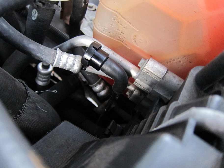

Attached is a picture of the updated front differential breather tube from my LR3.

nice...tlt, any word on the REAR diff breathers?
