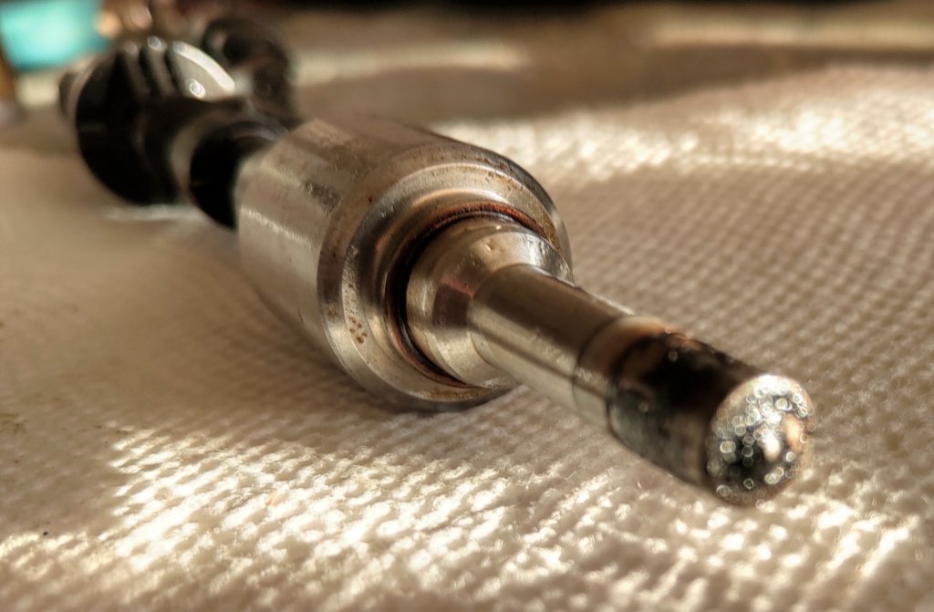

Ran into the same problem. At first rough idle on cold start. Random miss fire on startup.
Engine miss 2-4-6-. Guess what fixed this problem. # 4 injector carbon up.
Replaced # 4 injector and clean the intake manifold runners with upper cylinder cleaner injected through intake vacuum fitting.
Running good now.

Thanks @georgekale - I'm a novice with engines and to Land Rovers, but I'll give that a try to check that out. A friend thought it may also be due to timing being off, so I may have to figure out how to check for that too.
