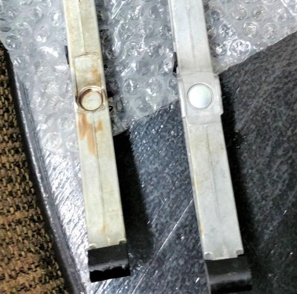

I’ve seen different statements on this. My original understanding is that the timing chain issue was the hardened steel tensioner piston wearing a hold through the aluminum guide (leading to slack). LR at some point redesigned the guides by putting a hardened steel insert in the guide where it meets the piston.
I‘ve read on these forums that they redesigned the guides in the mid-2012 model year, but the TSB on this issue (the one I’ve seen anyway) wasn’t issued until 2015 and that lawsuit linked above applies to 2014 model cars. So maybe it wasn’t fixed until sometime in 2014? Anyone know for sure?

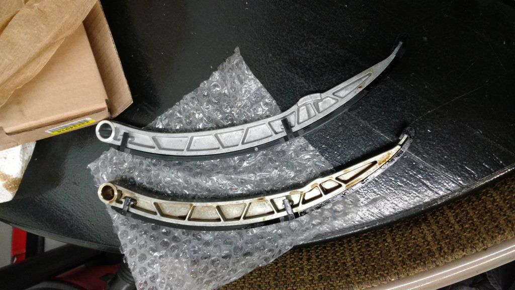

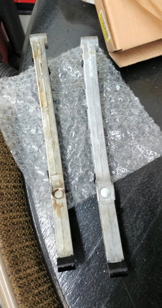

Here's what new and old look like.
