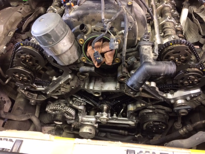

Hi, I just had this job done by a local indi. Here is a pic they send me while doing the repair.
I had them replace the water pump while in there.
All In all it was at 18 hour job they said. They replaced the timing chains in addition to the chain guides and tensioners etc...
