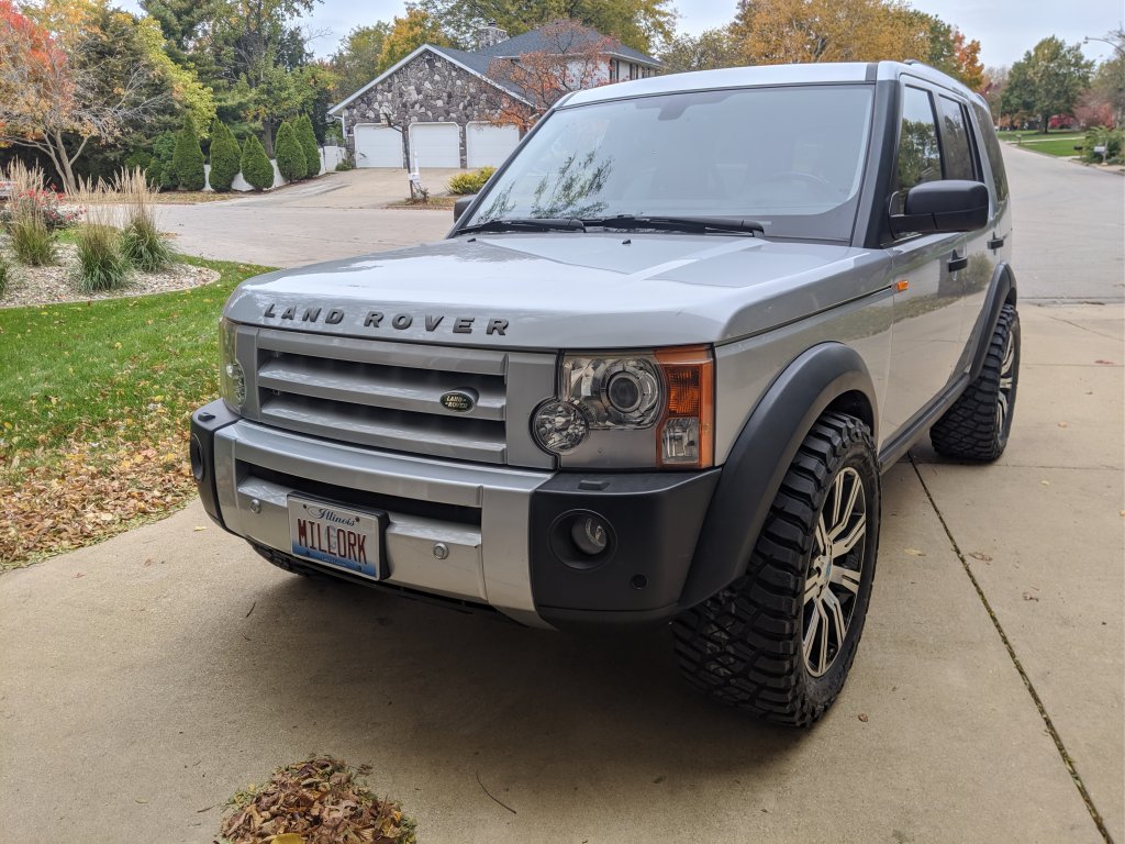

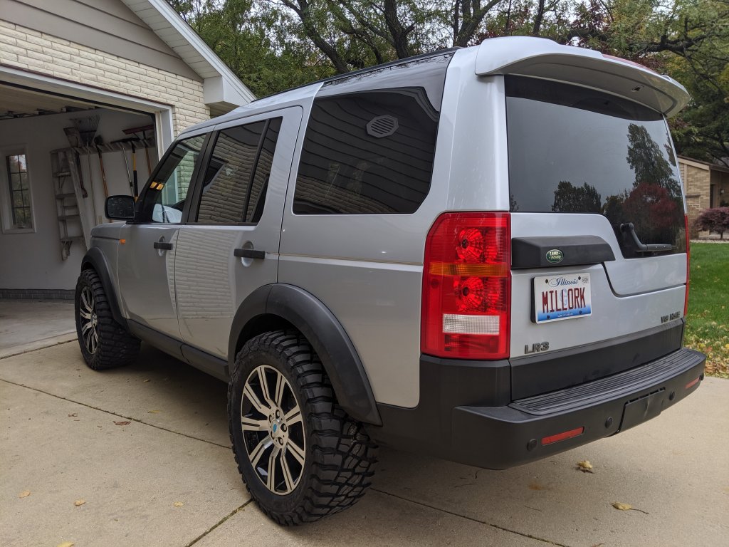

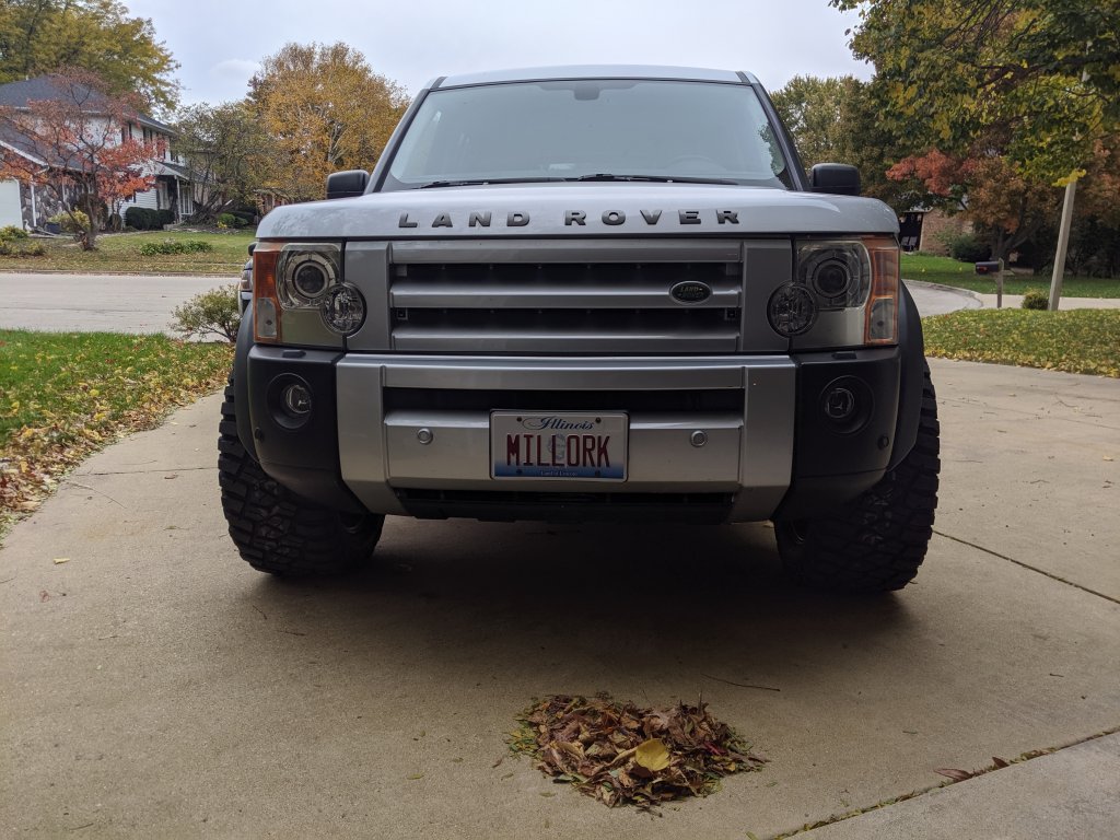

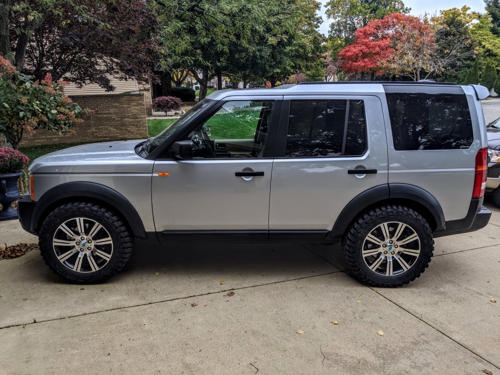

I feel your pain TrinidadLR4. I have always loved the Stormer wheels, so over the weekend I installed them with what I knew was an outrageous size 295/55/20. After all Lucky8 is now rolling on 35s. I knew it would require a lot of cutting, but damn it looks good. I used the gap tool to adjust 20mm up. No rubbing around town, slight rubbing in parking lot maneuvers, so I'll have to trim the front bumper a bit more or move to a winch bumper. My goal is to have it drivable in normal access mode.

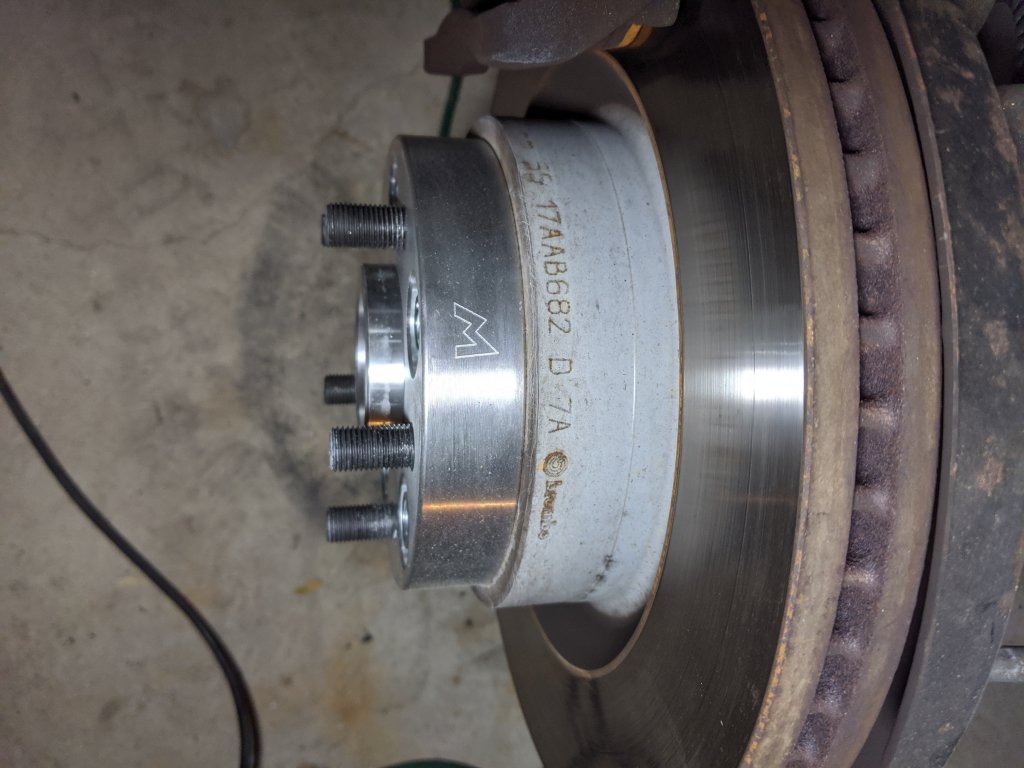

For those of you who mounted 18 inch rims with spacers, will 1 inch spacers give enough clearance? Are 1.25 needed? Did you have to modify your brakes to fit them with spacers? I’ve heard that filing down pars of the brake calipers is necessary?
3,097
1,881
Scott Brady, who pioneered the spacer and LR3 wheel idea, said that 1.25" spacers are needed. With 1", you'll have to grind the calipers a little bit.
Some still have to grind the calipers a little with the 1.25" spacers, though.
Troy A
Sep 28, 2019
350
254
San Francisco, CA
I’m running 30mm and had to grind the caliper fins down about 1mm. I had hoped to avoid doing so.

This looks great. Also with those wheels I think the grey fender trim looks better than it would if it were painted.
