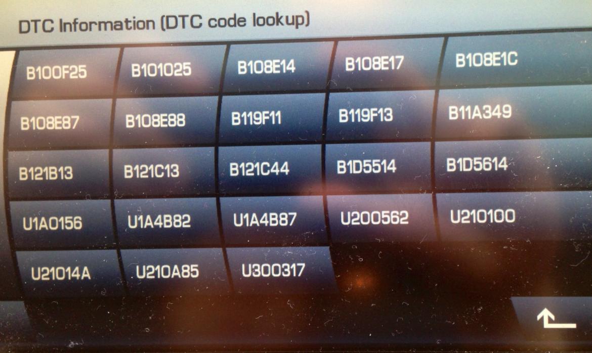

Does anyone know if this works for the LR4? Menu looks the same. Will give it a try tomorrow.
Just tried it and was able to access it.
For newer software versions, it looks like you have to hold your finger on the "Valet" button for approximately 30 seconds, then the "Hidden" menu opens.
It looks to be self testing information with a few configuration settings: you can change language and adjust what appears to be contrast settings for the screen.
