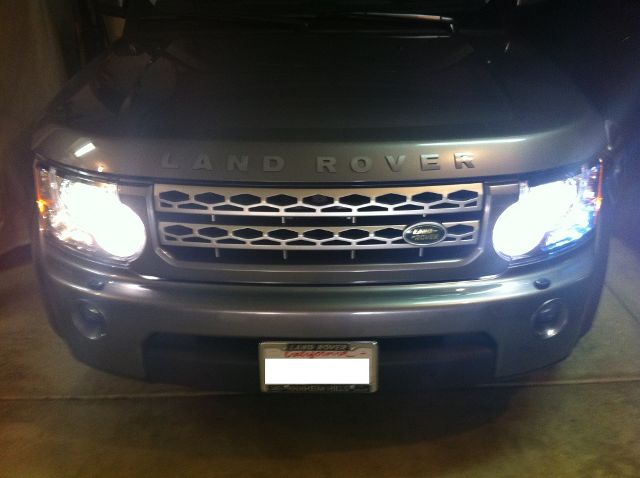

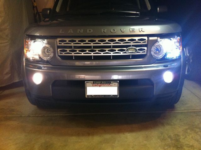

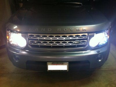

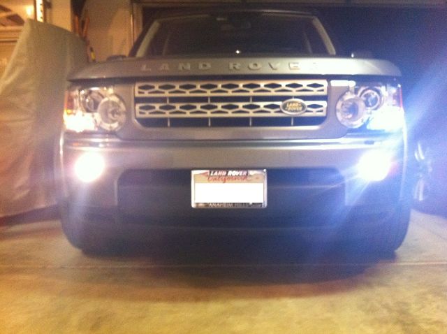

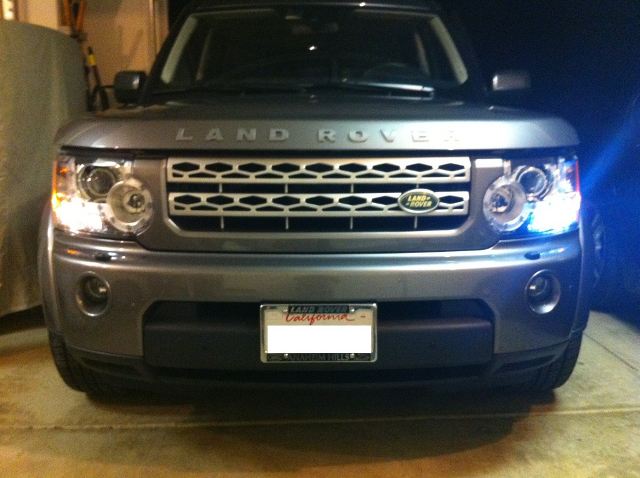

Well ... I just sprung for the entire headlight "conversion kit" I orderd the H11 and H7 CVs and the another post's LED recommendation for the front running lights. I'll install one side and see if I can capture a difference with old and new sides on with pix. Here's what I just ordered from Amazon :
Fog and Low Beams - 2x Philips H11 CrystalVision Ultra Headlight Bulb, Pack of 2
Running Lights - 2x Putco White 194 Type 360-Degree High Intensity LED Premium Replacement Bulb - Single Bulb
High Beams - Philips H7 CystalVision Ultra Headlight Bulb, Pack of 2
Well my lights came in a day early and being impatient, I installed them tonight and well the improvement is quite dramatic! Follow the tips in the thread to install and take your time. The only additional tip I can give is to get the screws back into the fog lights, you really should tape the screw to the torx driver otherwise it will be impossible to get the screw back in. Here are the side by side pix. The right side of the pix are the new lights. Sorry, but all I had was my iPhone ... enjoy!
