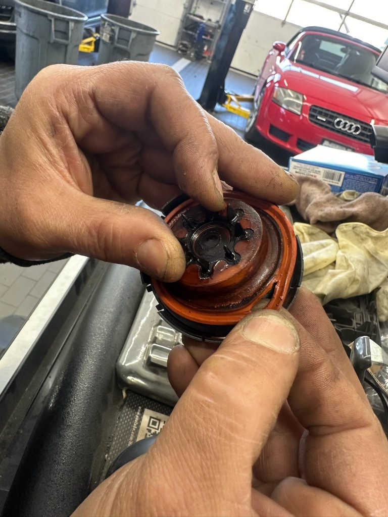

Ok so the mystery has been solved. No signs of oil leaking or burning but the oil was measuring 6 qrtz low. Turns out a breather tube cracked in the oil pan and the intake was full of oil. Surprised the car didn't throw off any errors especially from the oil measurement on the dash.

The more i think about this the more insane it is the oil meter didn’t indicate an error. Im lucky the engine didnt go ****.
