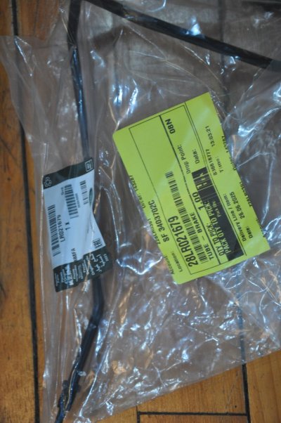

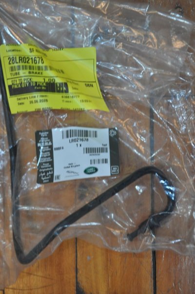

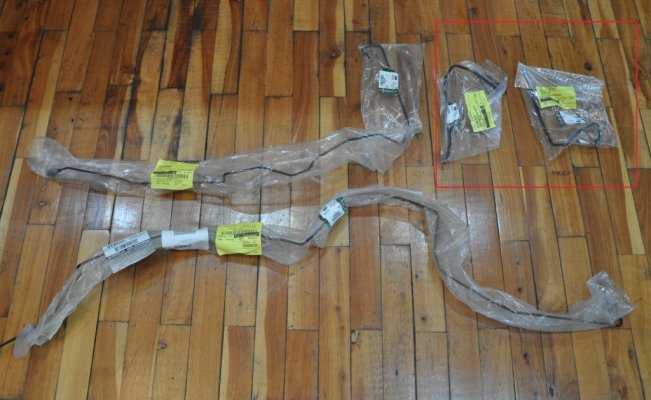

Second, we ran into an issue installing the rear stainless steel brake lines. There are two of the flexible lines and so we were going to put both on. However, there are those solid steel lines which have corroded and I ordered replacements from Land Rover Palm Beach. They did a great job packing everything up and I have now received the new lines - photos attached.
We will be doing the rest of the brake job, which includes the install of these brake lines and hoses, soon.

I wanted to follow up with this job. A bit of a bust for some parts.
So it turns out that the "long" steel brake lines I purchased to replace the ends going into the wheel wells...don't fit directly onto the factory lines after all. I think this is actually a refurb kit the manufacturer devised to replace the steel lines on the back end and address the exact issue I am having, which is corrosion on brake lines on the back end (in my case, at the fittings).
So to make those work, one would need to cut the factory lines, put a new flare and fitting on the mid-end section of the factory lines, and then fit the new lines to those in order to run to the wheel wells (something we were simply not prepared to do).

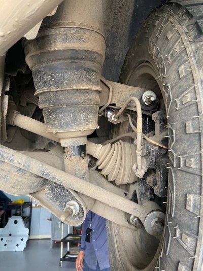

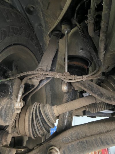

So after a lot of oil, careful turning, and maneuvering...we were able to get the original corroded factory fittings separated and simply replaced the short steel lines to the long factory line. In the first attachment, the short lines I am referring to which run to the wheel wells and the first braided stainless steel brake line (replacing the OEM plastic hose) are highlighted in red with the second and third attachments close ups. The long lines in the first attachment are the ones I thought we could just install onto the factory brake line (and are in the engineering drawings above).
So good news: we finished the job.
Bad news: we couldn't replace the rear-end lines as I thought.
But...better than bad news: I am keeping those lines in the event I do need to do that job after all (so perhaps another project for a "rainy day").

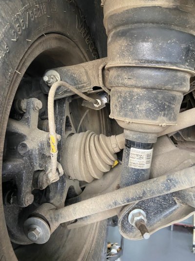

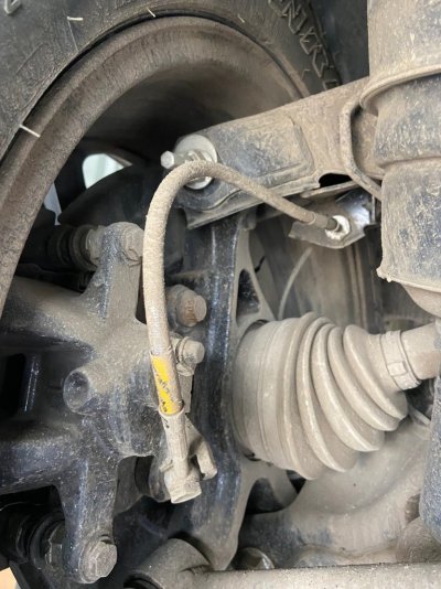

And here is the rear end after doing all that work...you can easily see the braided (aftermarket as mentioned above) stainless steel hoses. Unlike the front end, these hoses fit properly (we had to fabricate a couple brackets for the front end hoses out of sheet metal in order to route them properly along the wheel knuckles and then just painted those gloss black to match all the paint work we did in the wheel wells, such as the brake calipers).

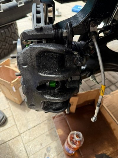

Speaking of rebuilt brake calipers...here is a shot of what the front calipers looked like as we were reassembling everything.
We have had no issues and the rebuild brakes are working great.
So we have come a long way and I am (overall) really happy with how these look and feel (once the work is done...).
Hope this helps!
