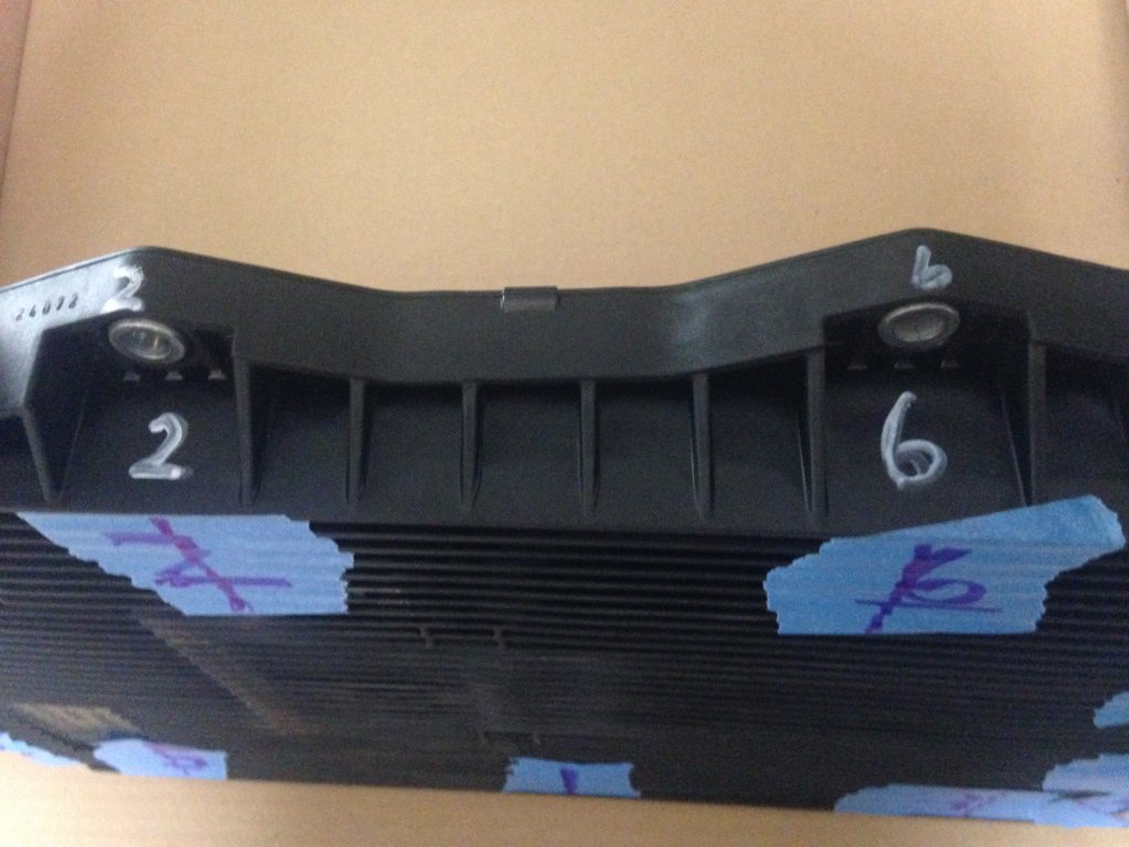

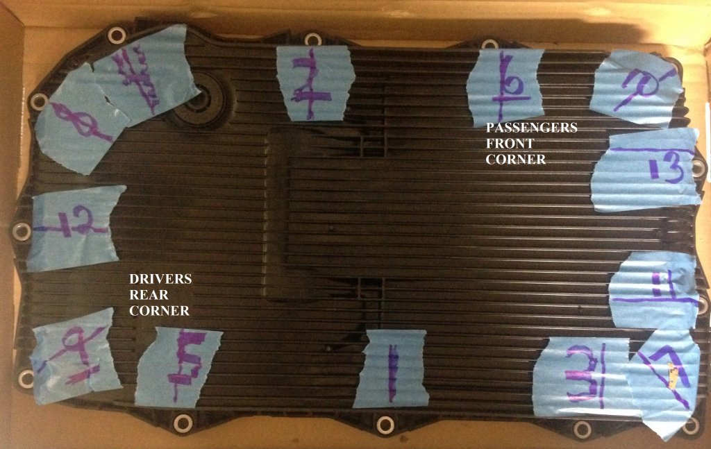

Prepare the new pan:
See the photos below
Label the torque order with blue tape - I also added alignment lines that I used to locate the bolts (not hugely additive, but I did use them at the beginning to get my bearings)
Label the torque order with a paint pen as shown - I used both top and bottom labels at different times due to visibility​

I suggest you take the time and label the outgoing pan with the torque order.
Because, interestingly:
Bolts 1-6 use the 2" T40 bit and
Bolts 7-13 use the 1" T40 bit
(Once I figured this out the world became a much brighter place!)
Easily accessible bolts use the long T40 at removal and at re-install, then the T40 2" on the torque wrench

Preliminarily torque in correct order to 5Nm
Full torque in the correct order to 10Nm
Check torque in correct order
Again:
Bolts 7-13 use the 1" T40 bit​
