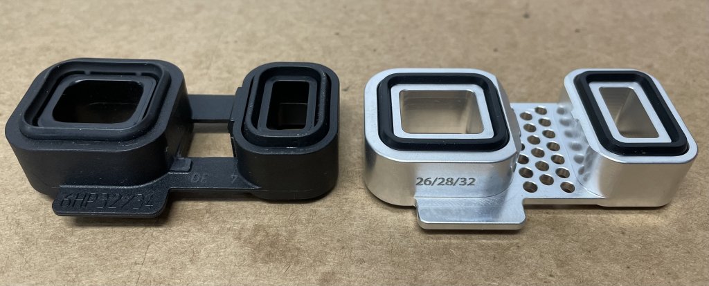

Also, picked up this aluminum bridge adapter from SFC motor sports. I’m still up in the air about using it. Just wondering if the aluminum will hold more heat and degrade the seal. Eyeball is identical to the ZF.

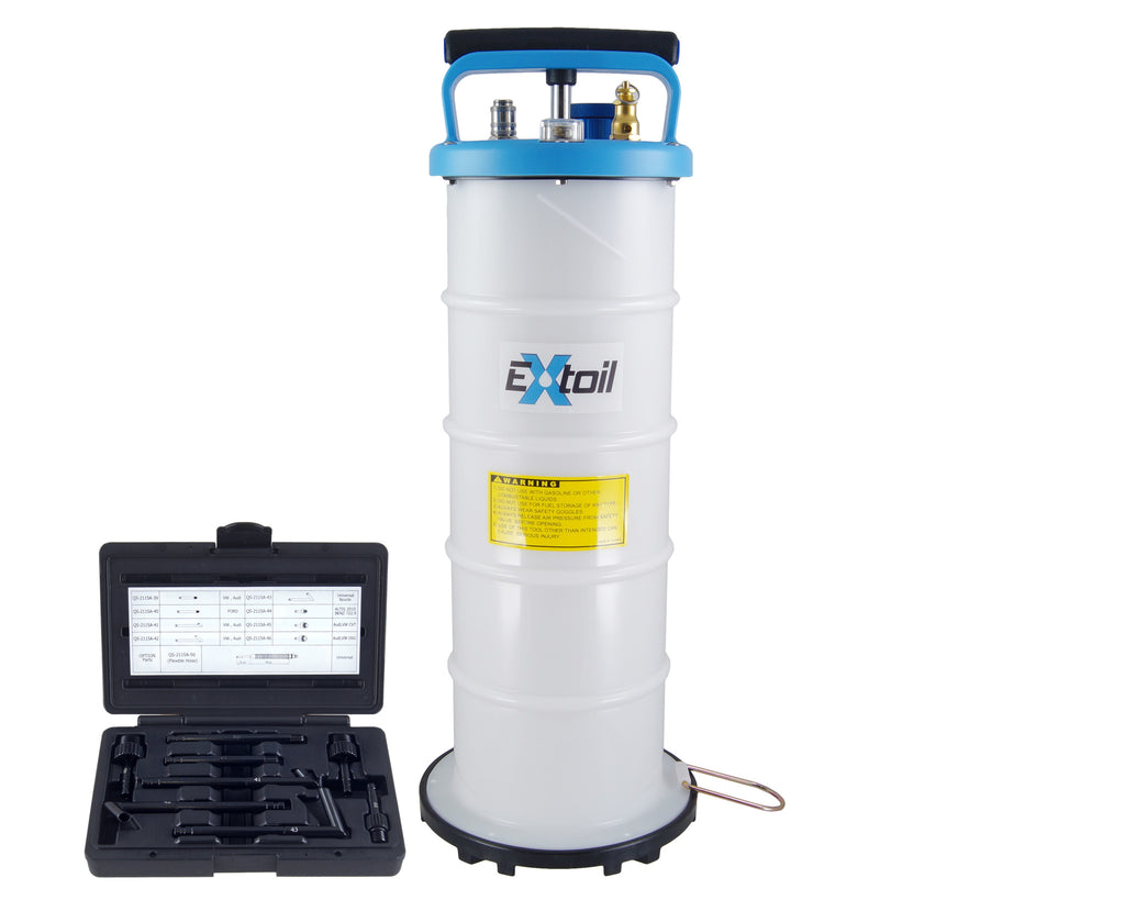

Think I've posted this earlier in the 24-page thread, but this is the pump I use to fill the transmission - works on most vehicles without a dipstick, that require pumping to refill:
