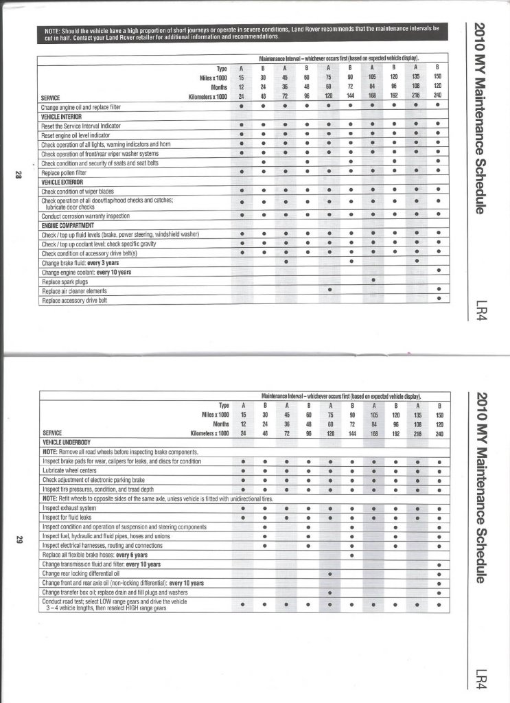

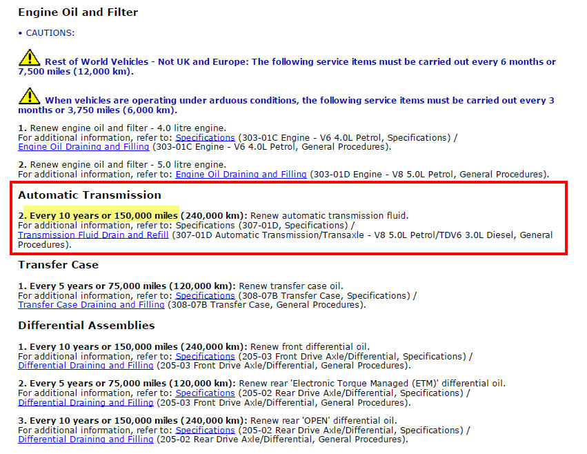

See attached maintenance schedule from my USA-spec 2010 model, note that it specifies the transmission fluid be replaced every 10 years / 150kmi. The factory service manual (FSM) says the same thing. Definitely not "sealed for life".
Also of interest is the FSM specifies an engine oil change interval (OCI) of 7500 miles for standard service, 3,750 miles for severe service, outside of UK/Europe... but doesn't mention what the UK/Europe change interval is. Meanwhile the USA schedule pushes this to 15,000 miles standard service, 7,500 severe. Hmmmm.
