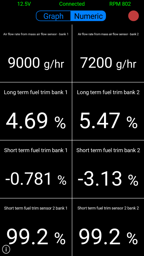

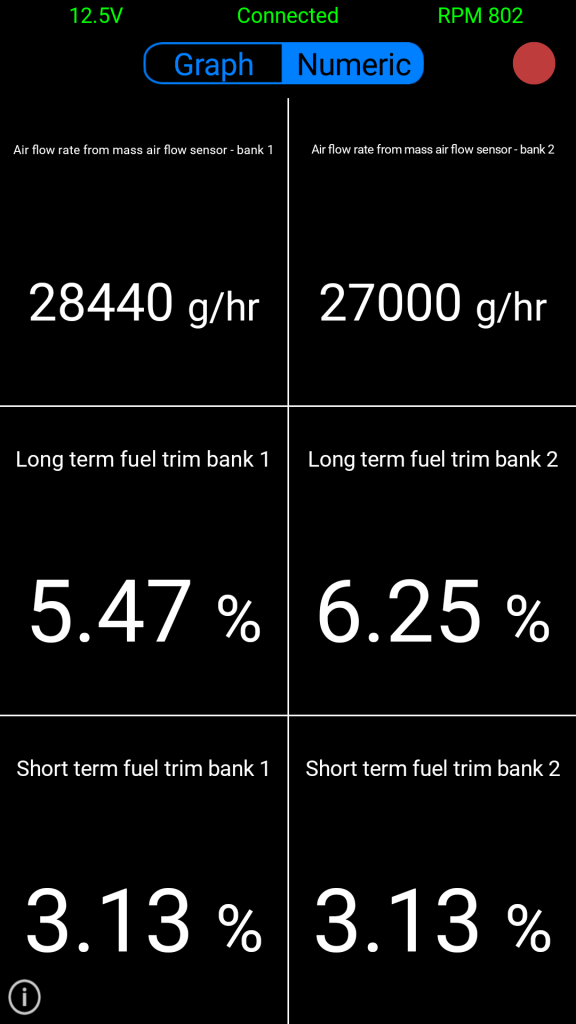

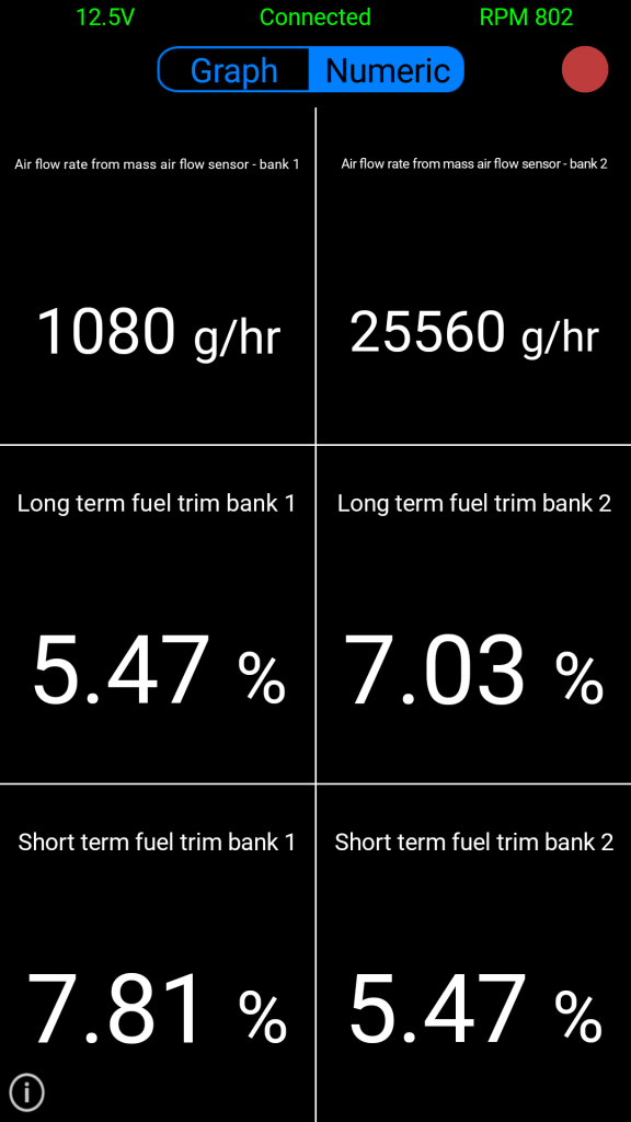

I was thinking bank 1 is faulty due to measuring too little air flow--element contaminated.
No codes other than those related to the start stop stuff.
Here is some better data:
Idle after leaving work:
Just pressed accelerator after slowing down:
Coasting, foot off of accelerator:
Obviously these are screen shots, but the live data shows significant drop in bank 1's maf reading once the accelerator pedal is released.
Also, LTFT and STFTs reduce (less positive) when accelerating or when the throttle is open, and increase (more positive) when coasting.
Symptoms of a vacuum leak in addition to the faulty MAF?
id agree. vaccum leak and most likely faulty MAF.
your idle conditions are the only thing thats alarming.
under load and coasting, the fuel trims seems to be behaving correctly.
