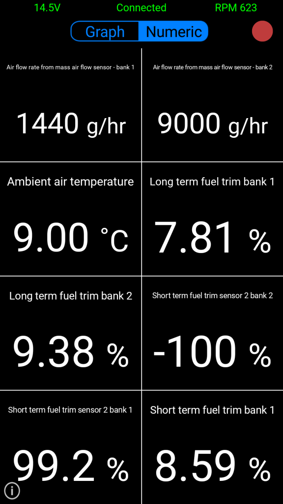

I had a little time this morning before work and thought I would troubleshoot an annoying idle issue (bogs slightly when coming to a stop, and occasionally will vibrate the steering wheel when parked).
Using my handy iid tool to log live values, this what I see:
I can lack common sense sometimes, but I see the driver side maf is under reporting and the engine is adding even more fuel (stft) to its learned value (LTFT). Does everyone concur that driver side maf needs replaced (it's already been cleaned a couple of times since ownership.
Also, I am confused by the o2 sensor readings. These are the o2 sensors after the exhaust manifold o2 sensors, but before the cats. One is super positive and one is super negative. What is this telling me?
Thank you as always for your wisdom and guidance!
Hi there,
Before you start buying expensive parts try swapping your 2 MAF sensors over and take a look at the readings did the readings swap over as well if they did you then know that one is faulty if you can afford it replace both that way you will know that the one you thought was good was not faulty for me when there are two of the same sensors on a engine I always change both together just like when you change a tyre I always change both that are on the same axle as this is the only thing that you have to depend on for your life.
Good luck in finding the cause of your problem.
Regards Poppy Ann.

With consolidated airflow, I am with you. No way that each bank's measured air molecules makes it into that bank's cylinders, through one throttle body, and churned up by the supercharger. But, I wouldn't be surprised if a land rover engineer thought it was a good idea...
Ignore the rpm at the top. It never changed... at a stop light, I actually logged rpm as well. Must have been a glitch.
Thank you for the comparison offer. I think the low reading MAF is at fault, but I will replace them both. I also have all the parts necessary to replace the exhaust manifold gaskets. I am not sure of a leak there would cause a rich or lean reading at the o2 sensor though.
I already smoke tested the engine once, but will do it again to rule out a vacuum leak.

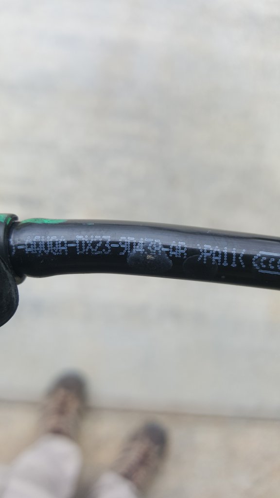

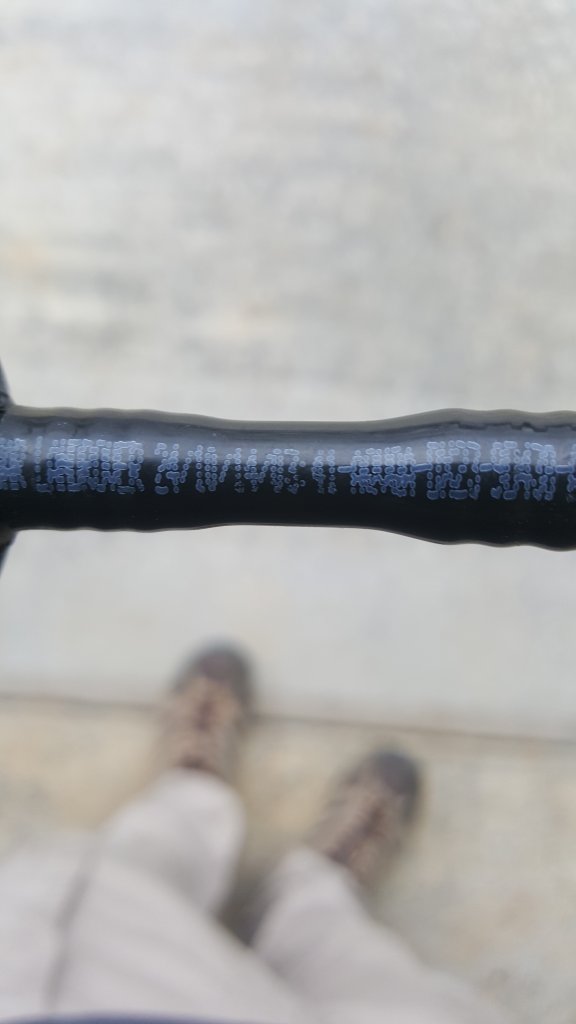

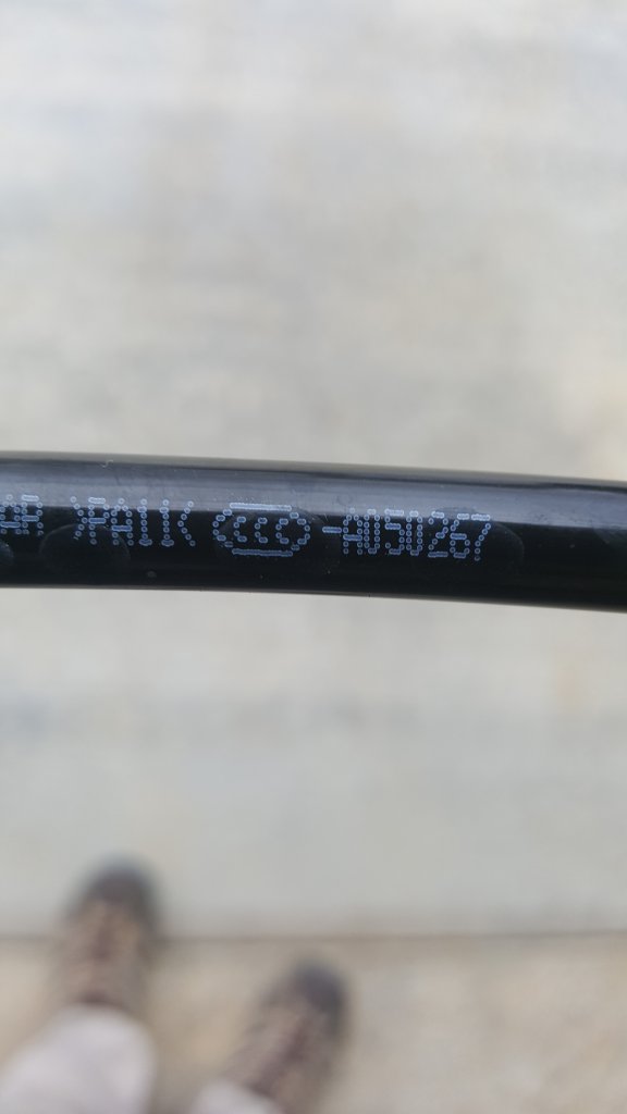

Still experiencing some bogging at idle, and some vibration at part throttle. So, I decided to pull the spark plugs; verify their condition, gap, and install torque; and check for vacuum leaks again.
Spark plugs looked good, but the gap was a little too close. I adjusted and torqued them to spec upon reinstall. More to follow.
Baby was napping so smoke test (air compressor) was not used. The purge valve is closed as it should be when not energized. The rest of the lines were tight and sealed.
However, the line going into the back of the intake manifold is loose. It connects fine, but slides easily on its post. I am thinking that it's internal o-ring is shot. On a side note, the check valve seems to work. It's open under manifold vacuum and closed under boost.
I typed its printed code into Google to no-avail. So, I sent a not to the parts website I normally use.
While I wait for the parts place to get back to me, does anyone know if the internal o-ring can be replaced without replacing the hose?
