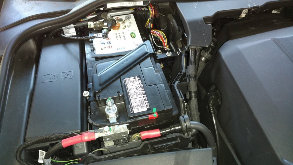

I was planning on adding a second battery with National Luna dual-battery system for my fridge and planned LED lighting until I discovered this

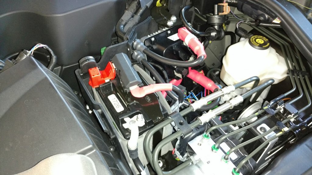

Second pic is the primary battery
Does anyone know what the amp hour capacity is of this second battery?

I doubt it's anything usable, just judging by its dimensions my little daughters' pink Barbie Jeep appears to have a more capable battery that that.
Seriously, that auxiliary battery is solely used for keeping things running for short intervals when Stop / Start is active, so the main battery isn't affected when your engine stops running instead of idling at an intersection, for example. I wouldn't rely on it as a deep cycle source of power for other devices you may be thinking about, such as a fridge, which may not draw a lot of juice but needs steady voltage available for potentially long stretches of time.
By the way, is Land Rover still using those mediocre Varta flooded batteries as primaries, or have they finally switched to AGM? Can't tell from your picture.

Exide AGM and yes that auxilary battery is smaller than whats on my Harley ;)
