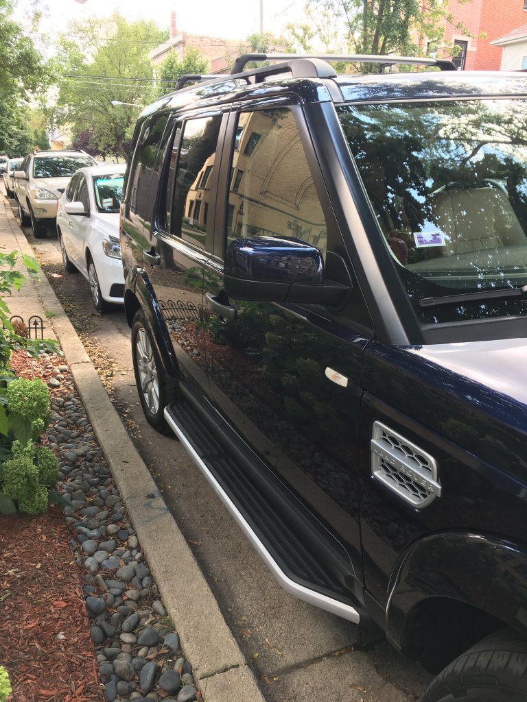

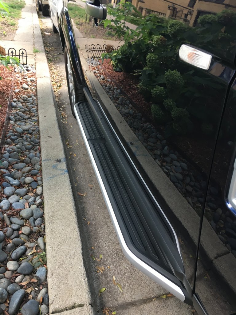

So much for an easy DIY. Took over 3.5 hours to install the running boards. The holes on the underside which arent covered with stickers were rusted and two of the cheap bolts that came with the running boards snapped. Ugh. But they did turn out great. Lets see how they hold up given they were $119 (aftermarket brand new on ebay)

Those look like a good stock knockoff. The stock ones aren’t that awesome so don’t feel bad if you see rust or pitting because that’s happening on my stock boards.

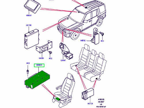

IIRC on 2014+ the memory module is under the seat whether you have memory or not. You can install the memory switch and it should enable memory seats which works in conjunction with reverse dip. Take a peak in the front of the seat behind the panel if not raise the seat to the highest position and move it all the way forward from back seat look under to see if the module is installed on yours. If so give it a go.

Can this be done on a 2013 ??
