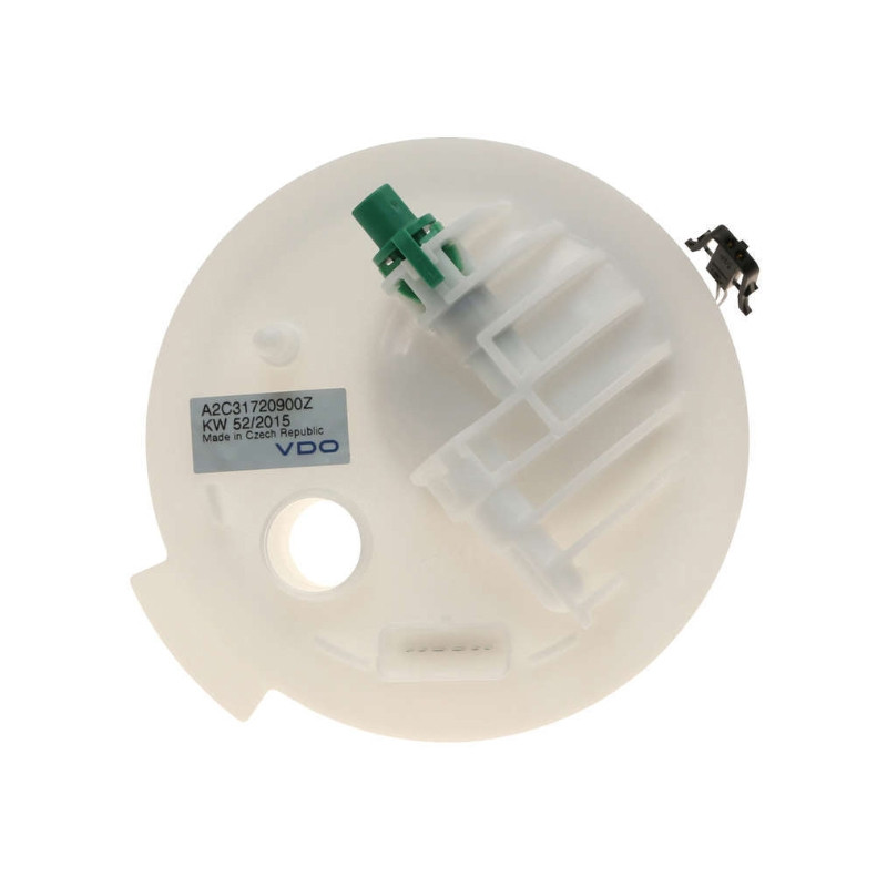

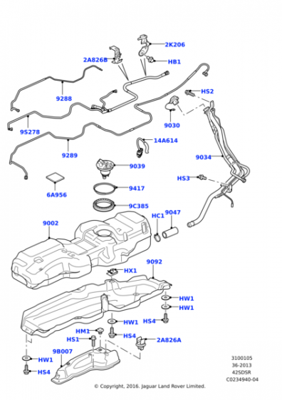

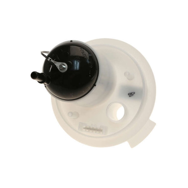

I'm not familiar with the tank design. Is there more than 1 flange / opening on top of the tank to be concerned about? Based on the diagrams it seems there is only 1 on top, with integrated filter?
Photos below are of the old/original style, I think. LR013750, OOS at most places, probably because it's being replaced with the new improved version.
