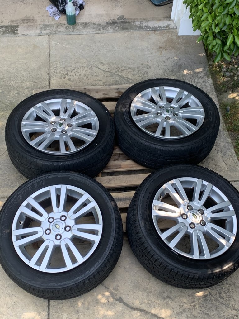

    I have a factory set of OEM 19’s sitting in my garage that are in good condition. I’ve had them since I switched to the 18’ wheels. They come with everything you need minus the TPMS which you can swap from your prior wheels to these. I’d sell all 4 of them to you for $1000 and we could meet somewhere in the middle because I’m here in Pasadena California. Let me know if your interested.

    those are perfect

    brian, buy those 19" wheels from Jimmy Brooks for $1000. ($250 each is a good deal as they are about $700 each new) Unlike Audi, there are only a few aftermarket wheels that work with an LR4. LR wheels are engineered to support the weight of an LR4 plus they have some sort of really strong bead seal that allows you to drop pressure if needed. And you want 19" for more sidewall.
