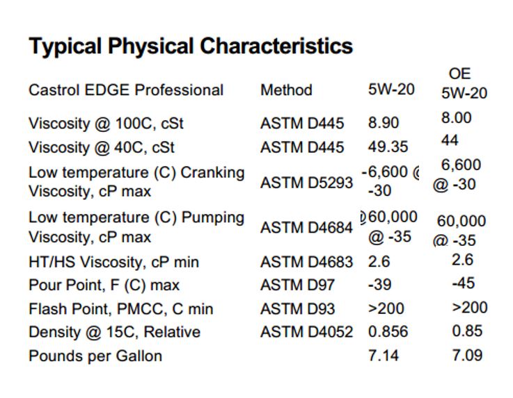

This is the PDS showing both the 925 and 945 typical values for Castrol. The big PDF has all the different weights, the png file I cut and pasted for easier comparison side by side. Now you can see what changes, depends where you live could be important.
