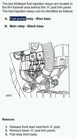

Also do you know if you can buy the relay at a normal auto parts store????

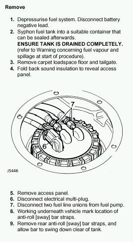

You stated that this is a '91 Disco? In the older disco's the relays are behind the passenger kick panel, in '96 and newer, they are under the hoold... You would have to pull in and check with a local dealer, not sure if they can supply one or not.
Relay modules
The two multiport fuel injection relays are located in the RH footwell area behind the ’A’ post panel. The main relay module is energized via the ECM when the ignition is switched on and supplies current to the multiport fuel injection system. The fuel pump relay module is energized by the ECM which in turn operates the fuel pump to pressurize the fuel system.
Ignition on
When the ignition is switched on, voltage is applied to ECM pin 11. The ECM then switches on the main relay by supplying an earth path at pin 4. This allows battery voltage to pass to ECM pin 28, to the four injectors and through the ignition coil to ECM pin 25. In addition, the fuel pump relay is switched on by the ECM supplying an earth path on pin 20. Voltage is
applied through the inertia switch to the fuel pump. The pump runs for a short period to pressurise the fuel rail. The fuel pressure regulator will open at its maximum setting and excess fuel is spill returned to the tank.

Just looked at the doc and read the article man .All i gotta say is how long you havd a rover??? they must have uploaded all that into you like th matrix...lol... Thanks well at least somthing good has come out of this I now know I don't have to take the fuel tank off to swap the fuel pump. Hey part my not be cheap be at leat these thing are realitily easy to work on. Kinda like the jeep cj7 i use to have but on steroids...lol.. Thanks again joey you are the man.
