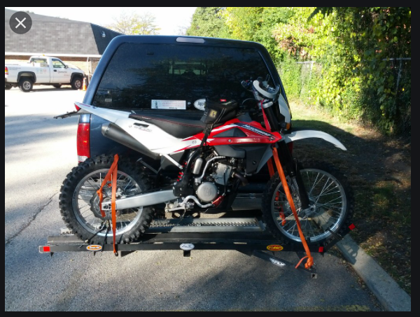

Something like this will get you where you need to go if the LR breaks down. Cuts the departure angle down though.View attachment 12548
Is there any rocking or oscillating issues clockwise and counter clockwise looking from the rear at highway speeds?
This when bike can not be balanced perfectly right over the receiver left and right?
Garage sale find a "Versa Haul" 600# rated carrier NIB after helping a person with packing up and moving out of state. Three hrs. labor was worth it I hope? Only talking a 297# bike 835 miles away purchase then bring home with the 95 Disco vs driving the pickup wo/air.
