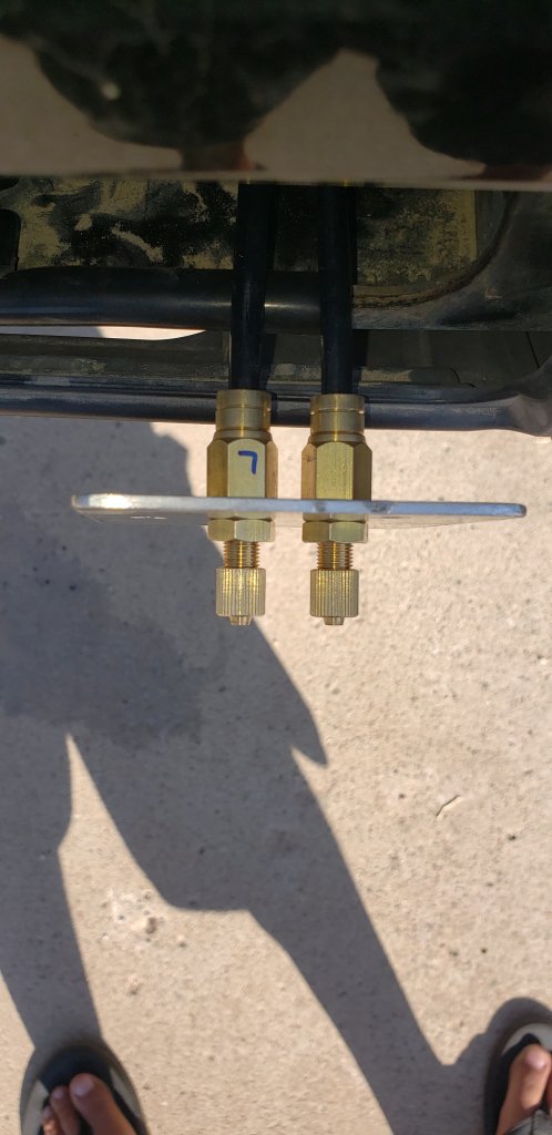

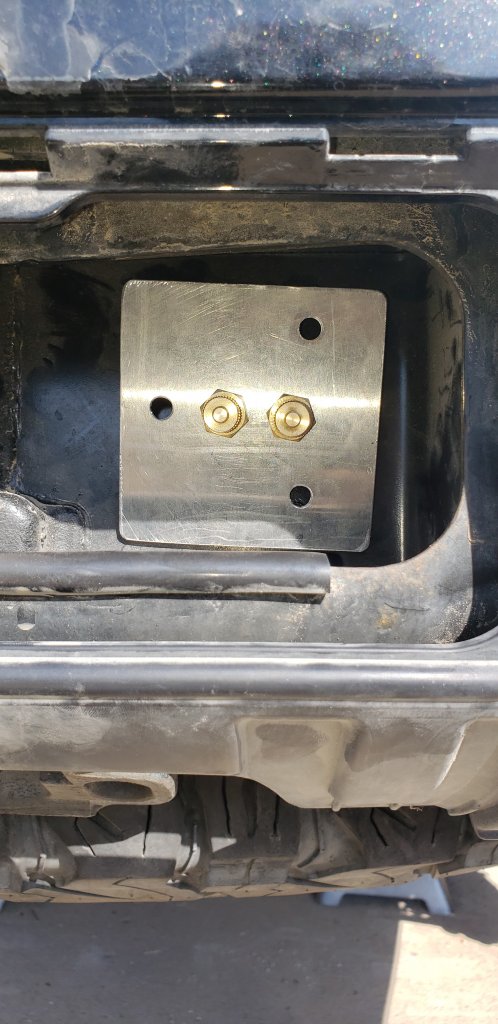

Even better, build like the actual GOE kit. Add extra air line to each corner and run a loop of the extra through to somewhere easily accesible. Mine are stubbed out above the trailer hitch in rear, and tucked just behind my grille in front. Put the union connector in those spots that are easy to access. If you have trouble, decouple the union and insert your scrader valve pigtail and inflate.
Much easier to do standing comfortably rather than crawling around in the muck on the side of a trail.

Ooh I like that. More of a permanent fail safe I see. Thanks for the tips. Definitely sounds easy enough to assemble. I may go ahead and have a spare compressor on-hand as well, just in case.

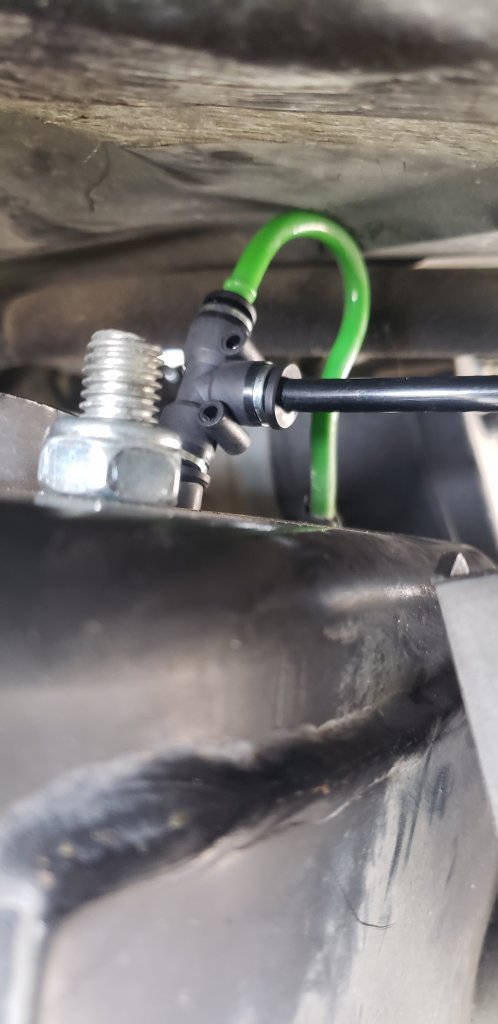

Curious how this fitting works. Is it essentially an always open 3-way connector? I guess that would work, so long as the problem isn't a major leak somewhere up the green tube.
It works assuming your valve block is doing its job, specifically cutting power to your compressor fuse F26 and the entire suspension ecu F3. I had butterfly valves between the valve block and tee fitting, but wasn't rated high enough to work.
The McMaster link had some 6mm end caps that'll be perfect to cap off the tee going to the valve block, which makes the schrader valve directly feeding the struts.
1,860
If there were a valve in that 3 way connector, whereby it wouldn't let any air up the green line (thereby eliminating the potential for major leaks in the green line or at the valve blocks), then I would think it would affect a normally-operating suspension's ability to lower the pressure in an air spring, as I'm fairly certain the air tube is also where the air strut exhausts air pressure.
Am I right in thinking that?
