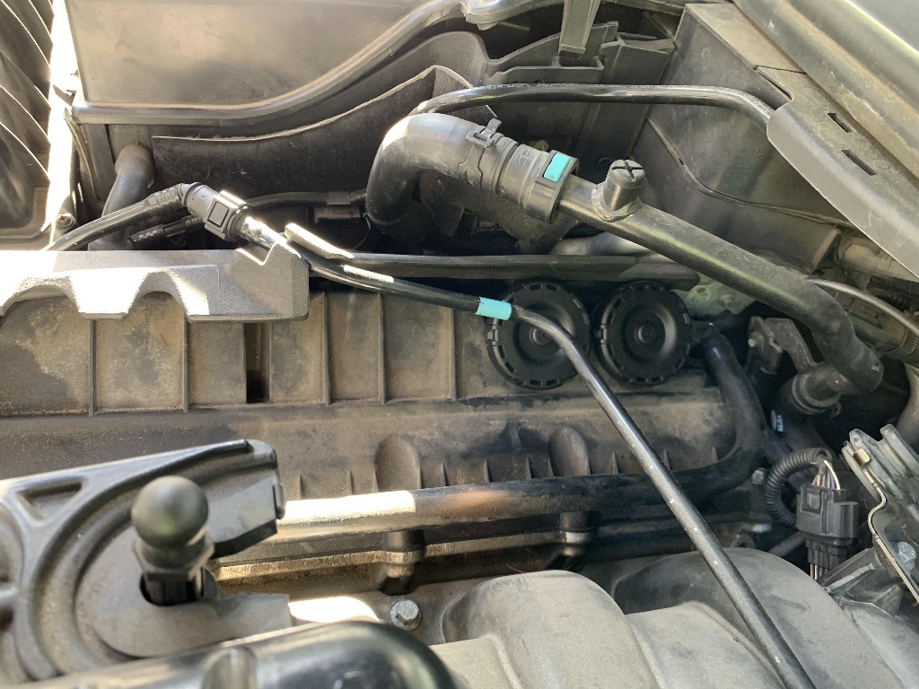

Now, I have to tell on myself as I’m about to highlight my LR ignorance. As someone who’s worked on engines for pretty much my entire life, PCV valves have always been directly under the breather hoses in each cylinder bank.....until this engine. As you can see in the pic, the PCV valves are actually both co-located in the right hand side (bank 1) valve cover. Like I said, highlighting my ignorance. I can honestly say, if you would have told me the PCV’s for both banks were collocated on one side of the engine, I would have called you a liar!

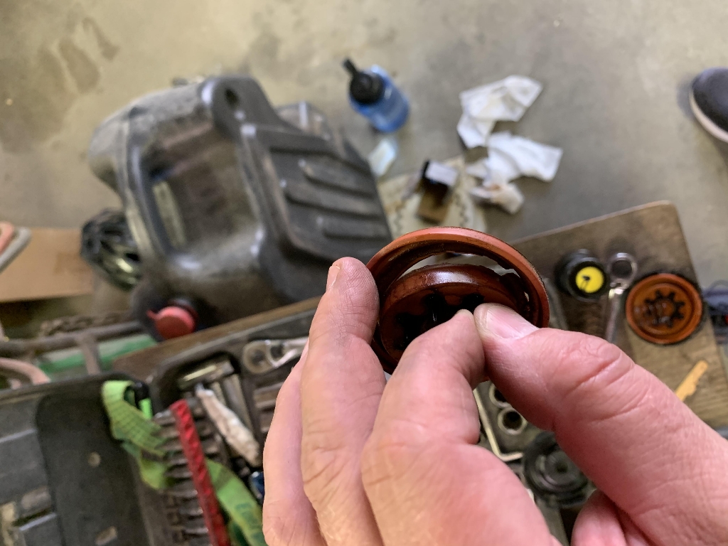

The hardest part was getting the old “caps” off the top. As would be expected, the little plastic “tangs” all the way around broke off as soon as you apply a little pressure. Thankfully, new caps come in the kits, so break away! Just be careful not to damage the valve cover side and you’re good to go! I actually used a right angle flat head screw driver to get the caps off. When the caps come off, pull the rubber diaphragm and spring out, clean the mating surface...I used baby wipes, then install your new parts.
A couple of things to consider. As you can see from the pic, one of the diaphragms was completely destroyed. The other one, (not pictured) looked to be just fine. Oddly enough though, the diaphragm that looked the healthiest actually leaked the most smoke. The moral of the story, don’t trust it, even if it looks healthy! The smoke never lies!!
