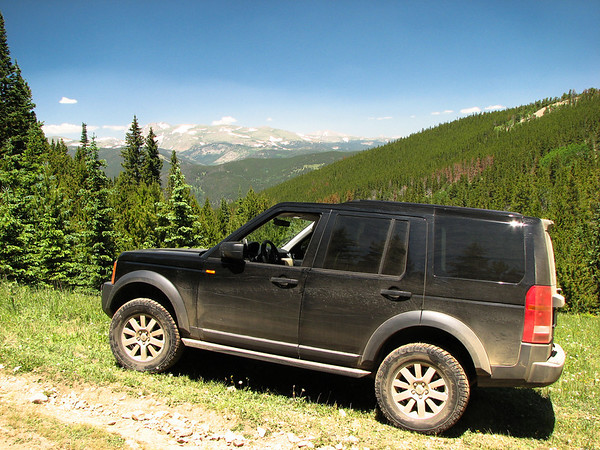

My rover is beyond dirty at this point - I've done some pretty narrow trails through trees the past couple of weekends and have started to scratch up the side panels pretty good. Last weekend it wasn't too bad, and a friend of mine and I were joking that I should just have clearbra plastered all down the side.
Today I did some really tight stuff with lots of trees and scraping, and got quite a few scratches. I think most will buff out, with one exception. After I take care of those I'm thinking more seriously about the clearbra solution - anyone have any other suggestions? The terrain being what it is in Colorado, I have not seen the last of tight trails with scratch potential.
Here it is - that white line down the side appears to be through to the primer:

I have the same issues on our CA Coastal Ranch. I carry some serious clippers and an axe for preventive trimming. I have found that using a griot's Random Orbital and Polish #1 followed by Polish #3, followed by their Sealant or Meguiar's NXT wax, will get rid of the marks. For deep scratches, as long as it is not down to the primer, you can grind it down to where it is really not noticeable -- some freaking self-righteous anti-SUV type keyed my beast and left a your "destroying the universe" ticket in front of REI. For scratches down to the primer, I use the Langka kit.

Other than the clearbra suggestion you have already made or clearing the trail prior to having fun, I can't think of anything that will prevent scratching of this magnitude.
Light stuff I would say a real heavy coat of wax...

I believe you can buy rolls of 3M clear bra very cheap, and it is *very* easy to install. I've bought two kits off of eBay - one for our LR3 and one for a friend's A4. Both went on super easy (although the LR3 one didn't have cutouts for the hood letters). If you just get the roll itself, you can cut it to cover your doors, etc and it will be really easy to install (flat panels are by far the easiest). The stuff is actually cheap enough that you could almost do it every time you offroad (put it on, take it off, put it on, take it off).
Simple instructions:
Get a squegee and a spray bottle filled with a 5% solution of water and baby shampoo. Make sure the car is super clean (use dawn to wash it) and then spray everything down with the solution - make sure to use lots of it. Then position the piece (it will move easily with all the soapy water) and squegee out the water from in between. If you get small air bubbles, you can try to work them out with the squegee, or do it the simple way - with a hair dryer. Park it in the sun for a few hours and it will be perfect.
