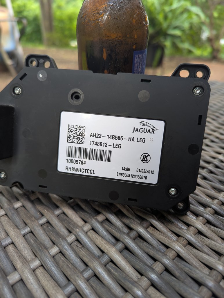

Got the damn button module out! When did exposed screw heads become such a bad thing Got rear screw out easily but front screw of button seat panel a bi$tch! Finally said f'it and Dremel'd a bit of plastic away to get access.
Have two LR4's in boneyards nearby, but decided to just order $40 eBay replacement. Cost me $40 in gas alone to get to the yard.
But ha ha... No wonder it may have failed! Jaguar part!!

Woop woop! Got my replacement control button unit in mail and that fixed the issue! Motor was fine but recline button broken.
