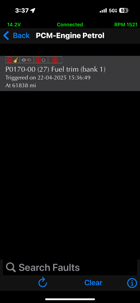

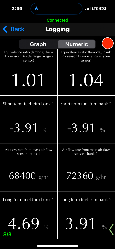

Fuel trim screen shots, but again, this code hasn't reappeared today. It’s the misfire I’m more worried about today.
