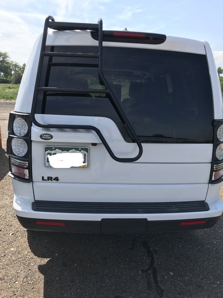

Here's a quick pic @iSurfvilano I actually like the additional step. I'm 6'2" and don't really have any issues using the upper step first however having the additional one actually works to just give me a little extra boost. The angle at the top looks a little off in the pic, it's pretty flat though.

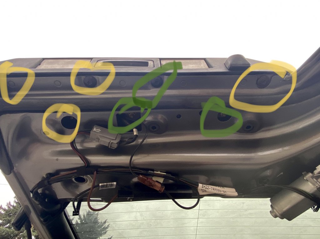

Anyone run into an issue with the t30 torx bolts? I went to undo mine but they just spin freely...
Are these the bolts for the license plate area? Its been a few years since I installed mine. I vaguely recall having an issue, send a picture to jog my memory.
It happened with one of mine. The bolt was rusted into its threaded sleeve--which is threaded into plastic on the handle assembly. Only solution was to remove the whole handle and use channel locks on the sleeve while turning with the T30.
Good news is that the sleeve will screw back into the handle once you get the nut(s) out.
Good news is that the sleeve will screw back into the handle once you get the nut(s) out.[/QUOTE
The yellow bolts (and one nut) spin in place and the green ones are the ones that came out.
Anyone have any tips for what to try next?

Yep. Keep turning counter clock wise and the sleeves will release from the handle assembly. You then remove the handle assembly and will have to remove the sleeves from the stuck bolts and one nut.
I honestly do not know another way to do it.
Oh ok, so you’re saying if I loosen all of those boots the handle assembly will remove regardless because the sleeves will detach from the assembly? Seems odd but I’ll give it a go.

The other posters are correct I had the exact same thing happen. Make sure you use metric drill bits not standard to get the correct fitting when it comes to the drilling portion.
Exactly. I wish I took a picture to help illustrate better.
