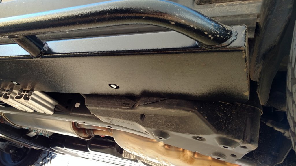

They look great! I have the Tactical 4x4 sliders and they were pretty easy to bolt up, but I did have to apply some rubber strips to where they articulate with the frame (due to creaking, a common problem). Their protection was amazing and fit and finish great. After the winter, I am going to drop them again, clean them, and re-paint. I also have the gas tank skid and transfer case skid and they work great, though the transfer case skid does hang a bit lower than I expected.
Got any pics of where you added the rubber strips? Skid plates are on the short list here, just not sure which ones I want to do yet.

The ProSpeed came with rubber strips for the top edge behind the doors, you can see it in the first pic. They're pretty substantial. Guess time will tell if the underside needs it as well. Thanks.

here is a shot of my Voyager sliders. Protection of the air compressor is suspect
96
That's why I went with Tactical 4x4 because I had several sets of sliders between my 2011 and 2013. I have had the Voyager, Urban Offroad, and GN Vehicle Protection. The plastic compressor case on my 2011 was crunched up pretty bad on some rocks, so when I got my 2013 I went with Urban Offroad because I got a good deal, but realized quickly I needed the Tactical 4x4 when I saw their level of protection. Sure, I like some of the others better, especially since they are not as heavy, but I guess at this point I don't care anymore about the weight.
