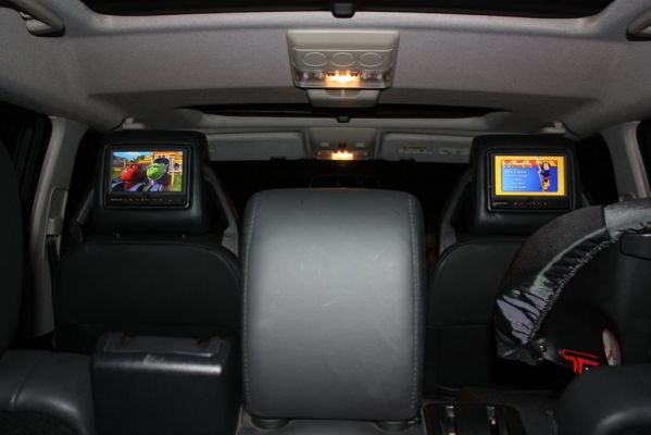

The units I fitted were made by Rosen, I think they are from America somewhere. Not the cheapest but IMHO the best system around for the headrests. You need to trim the handles a little but its an easy job. The best thing about them is that the headrest actually move!

Hello David
Yes I had them installed professionally took them 2 hours from start to finish which I think was very good.
They don't seem to be as squashed as the pictures of the other member whom has installed them,maybe they are not as wide as his.
Also the zip up security covers are brilliant as you don't even know they are in the disco.

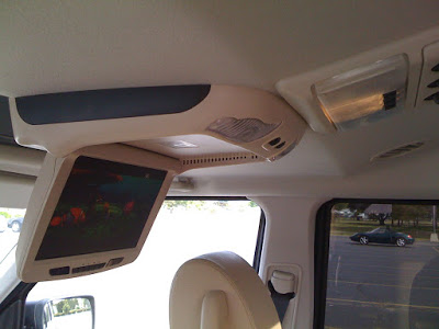

Only issue is that roof mounted ones are soooo high for children under 10 years (even in safety seats / boosters. They get a crooked neck...
morrisdl
Jan 1, 2009
717
38
David
I looked into the roofmount but could not have one as twin sunroofs,they said I could have one but I would loose my rear air/con controls....
Regards Albey
Mine with sunroof and roof controls still intact:
There is a full writeup with part numbers in the show of your mods thread. $300 I seem to recall.
