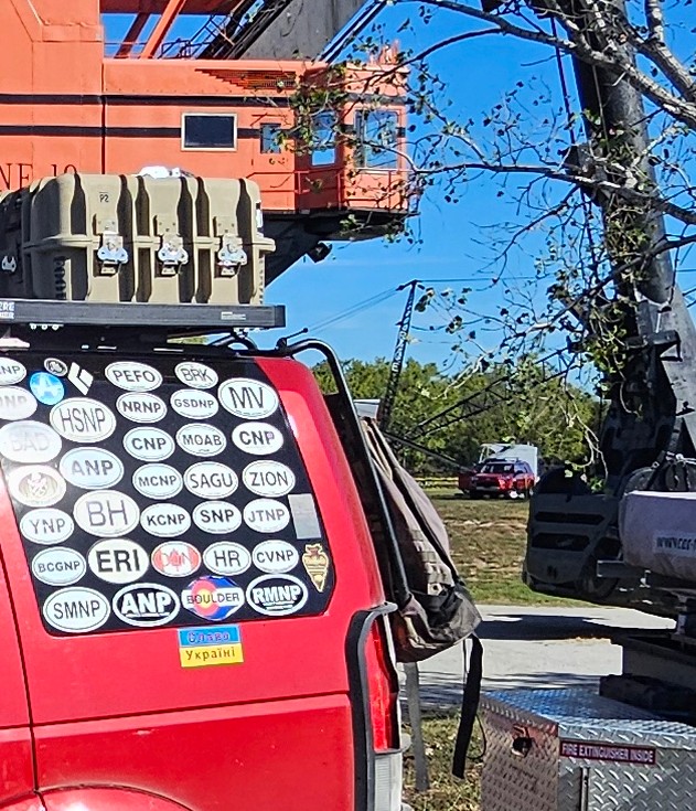

My advice:
1. Frontrunner, Gobi, or Stock. I've seen some new aluminum ones popping up on the auction sites, I wouldn't trust them..
2. Wherever you have paint and metal touching, apply thin sticky rubber matting to the paint. Use of the ladder can cause a lot of rubbing (especially at the top), and you don't want any rust forming up there..!
Keep in mind if you are going to use your roof rack a lot, the ladder going to take a beating, so don't hesitate to pick up a used one and freshen it up.. I've repainted mine 3 times with that spray on truck bed stuff, it's really grippy when it's wet/frozen out. I'm running a stock ladder that's on double duty holding the garbage bag, so it lives a busy life on the trail.
