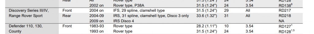

I have no idea how applicable, but ARB has a rear locker listed on their product sheet.

Yeah, an interesting piece on Expeditionportal.com & it confirms what ARB (based in my home town of Melbourne) have told me in the past - the LR4 diff housing is too small for the air-locker & at the moment they are not working on re-engineering their unit to fit. Same story as "the even better than ARB"
Harrop E-Locker.
I'd only fit the ARB front locker IF I can eventually get a rear locker. A front locker alone can not do the job when a rear locker is seriously required - weight transferring rearwards on a tough climb.
I'm sure some engineering genius will eventually design one for the later D4's as more & more offroad enthusiasts will demand a unit as the D4 becomes more affordable second hand.
