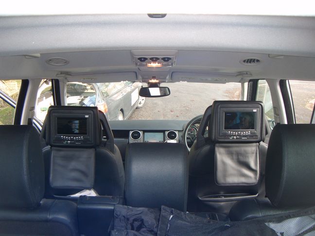

aleby
Jan 29, 2010
12
rear dvd entertainment
Hello
Maybe have a look at the ones i had installed,they are very good quality at a very good price all wireless headphones & wireless game controllers also with FM transfitters
Regards
Albey
