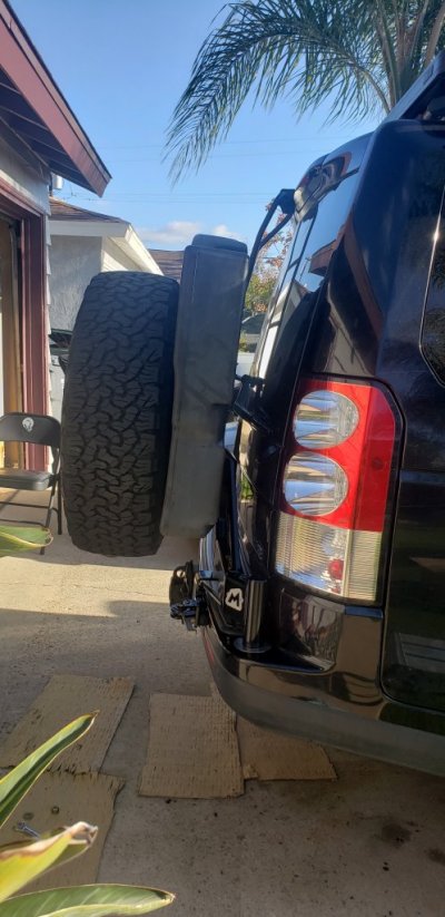

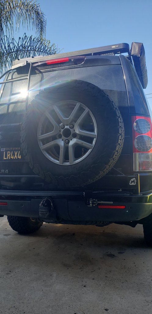

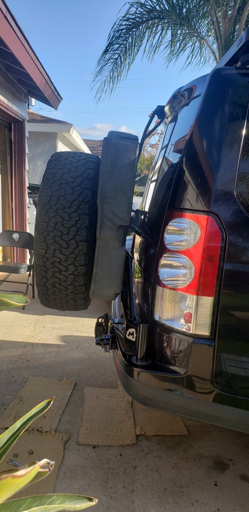

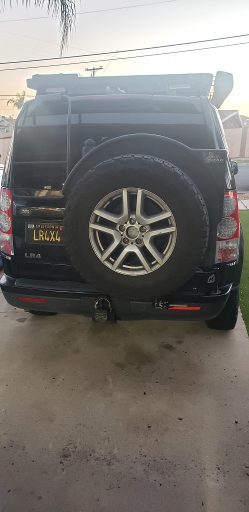

I have the Terrafirma one and it's nice. The strut definitely was a nice touch to help swing out and keeps it there, but it only swings out about (guessing) 95°.
The latch is simple enough that my wife and kids can latch/unlatch it. I put a tiny pin in it to keep it from accidentally popping out, never an issue. It's easy enough for daily access.
The tire carrier doesn't have a weight capacity limit. I have an email thread with a vp level at Terrafirma and Lucky8 with me field testing a full 15 gallon fuel tank and a 255/70r17 KO2 spare tire hitting the trails hard without any issues. I didn't get any compensation or anything.
